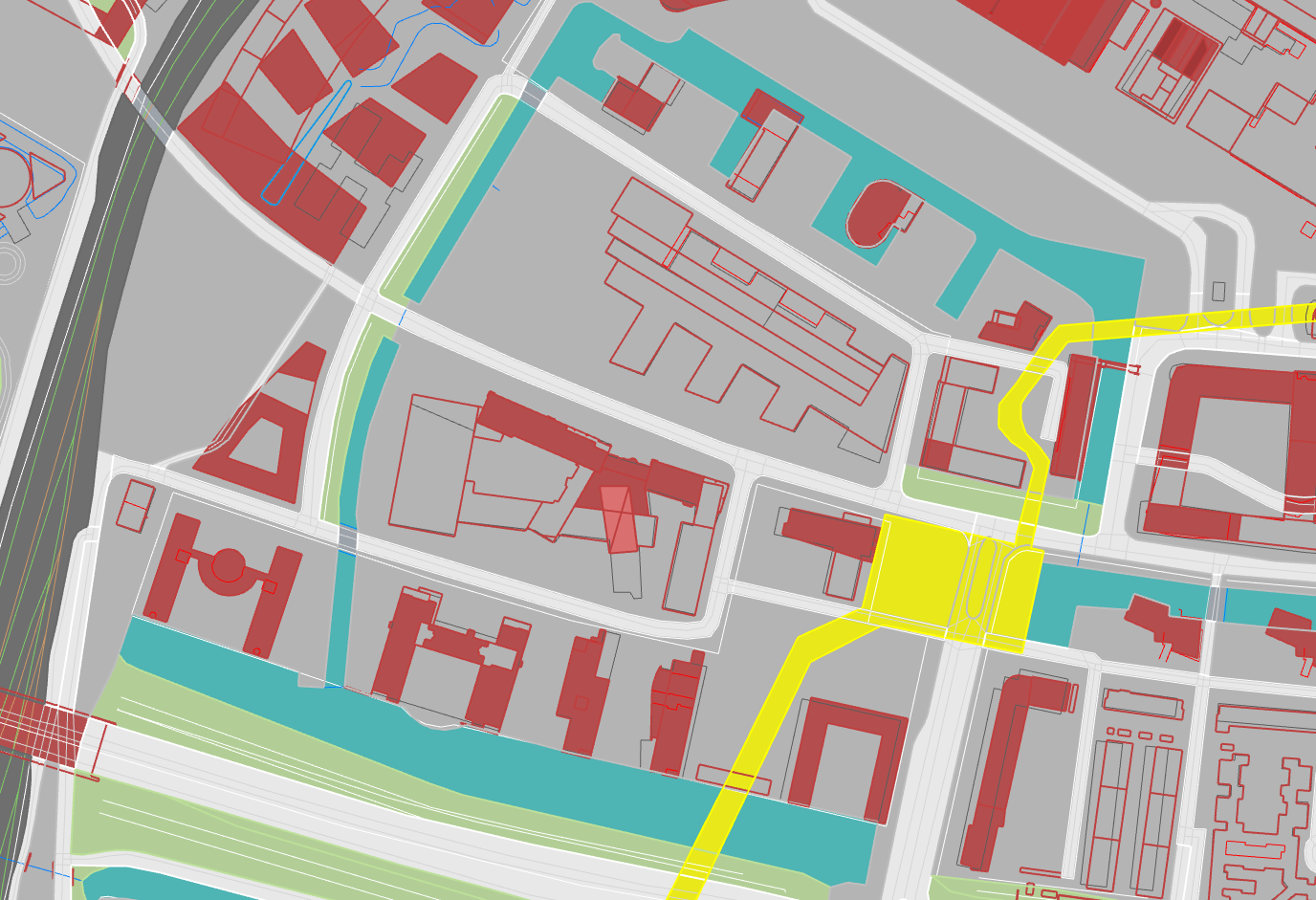

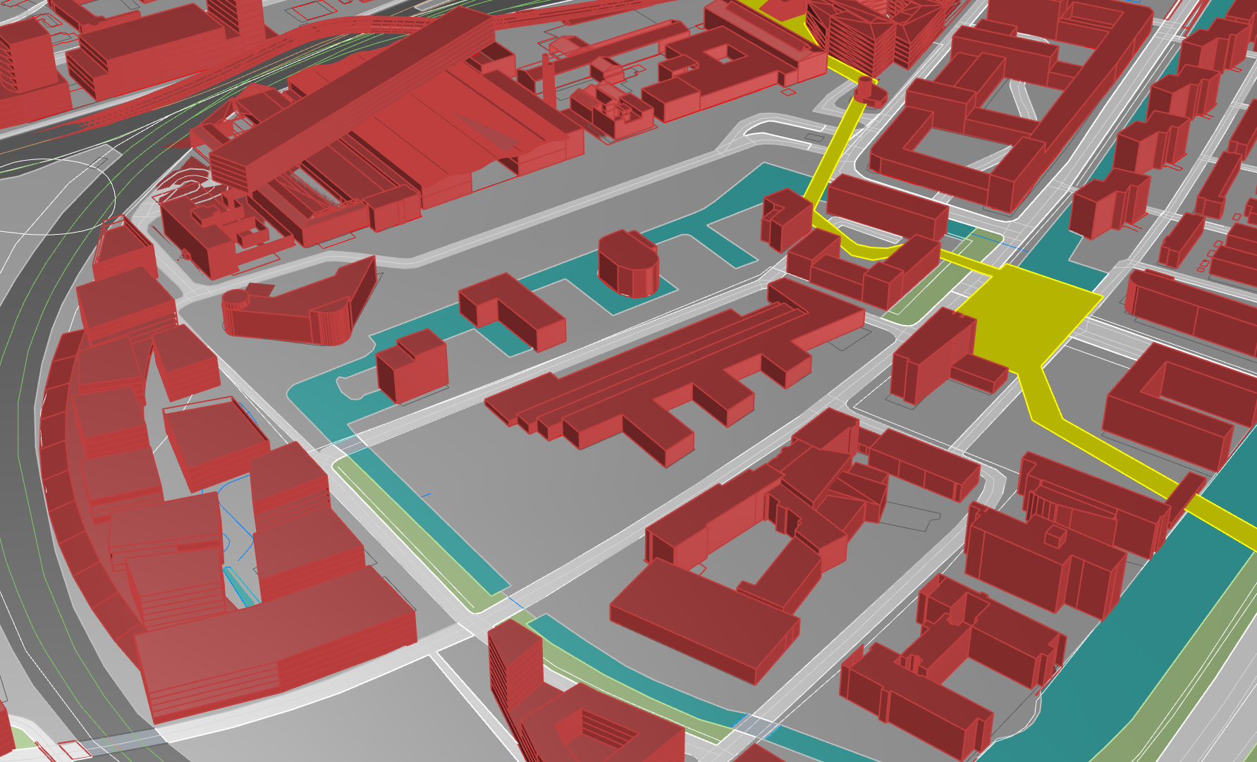

I am getting plans with viewcapturetofile command, but in plan view it doesn’t show the solids of my model. Does anyone knows why?
Is the Top (Plan) view in wireframe display mode?
nope it is not. some of them are fine and the others not
If you select all the objects in one of the views where there is a problem (like Top) and then run the command _SetObjectDisplayMode, then set it to Mode=UseView - does that help at all?
If not, maybe run the command SystemInfo in Rhino and copy/paste the results here.
How far is your model from the world origin?
how do I check that?
it worked! thanks
