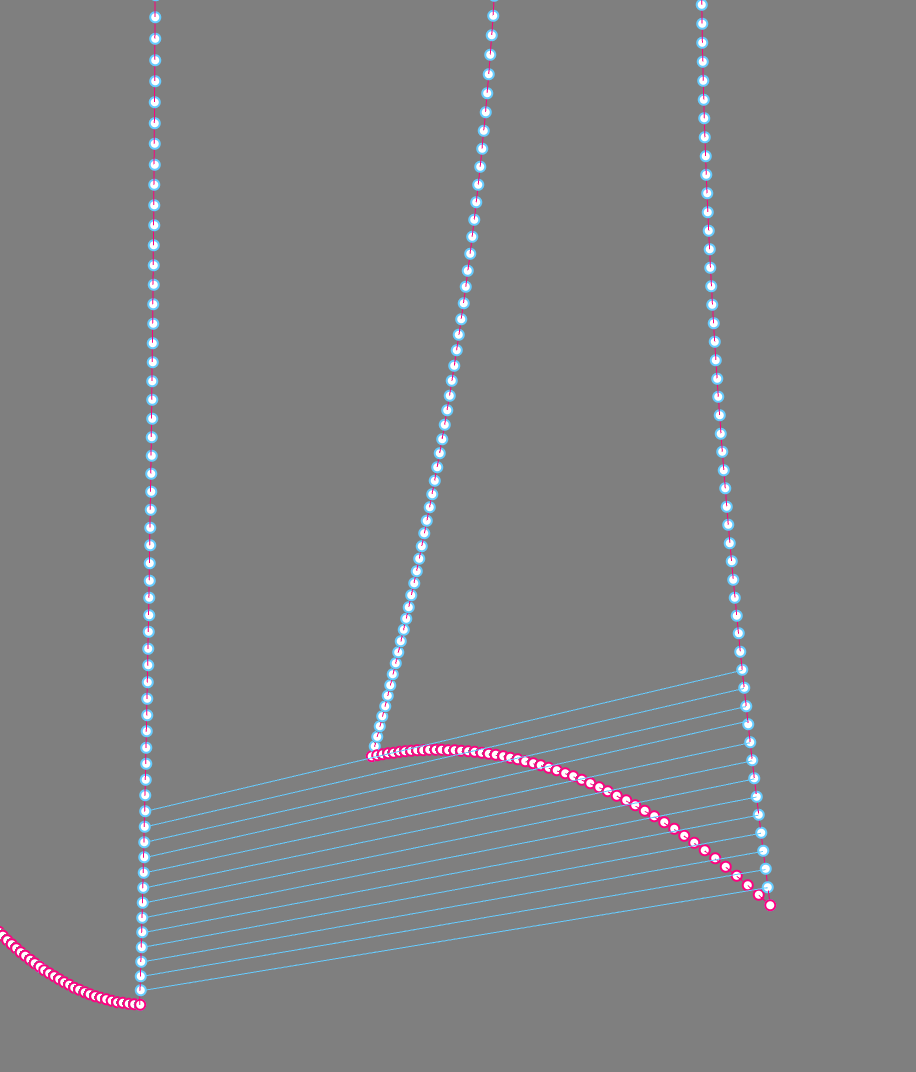

Hello I am trying to create lines between certain points that are equally dividing a curve.
I cant use tween curves because its following certain curvature…
Is there a command that I could use to connect point with point ( all at the same time) without having to draw every line.

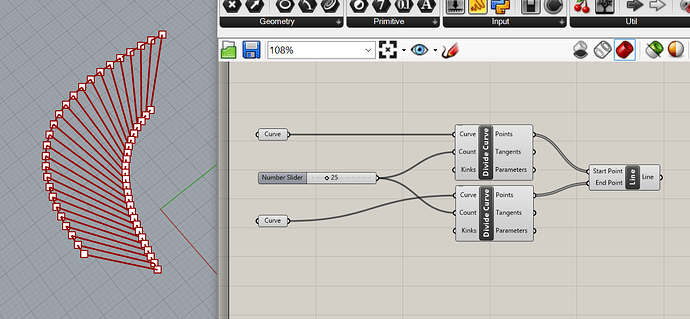

Hello - this is a case for Grasshopper, I would say.
ConnectPoints.gh (10.7 KB)
