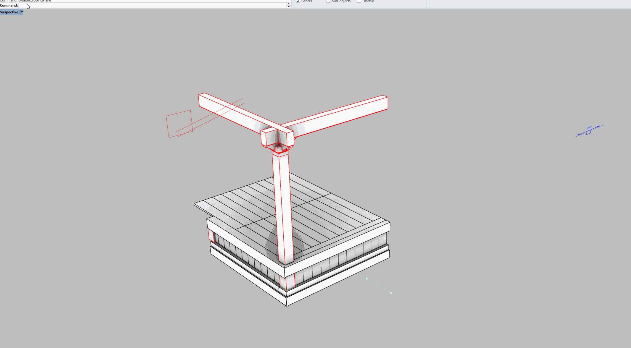

Trying anyway. Here’s a case where a section fill was created with section styles, and then the objects were moved. The fill displays when the clipping plane is enabled (often that doesn’t work though) but it remains where the objects were when the section style was applied.

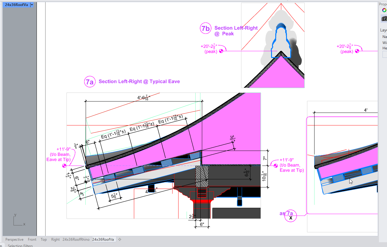

I seem to be having some success with some objects with the sections on the right, but the one on the left only shows the chosen fills when it’s selected. Otherwise some objects persist without fills, as in the image below. Some are in blocks, some aren’t. Several objects which aren’t showing with fills appear to be set with the correct section fills Section Styles.

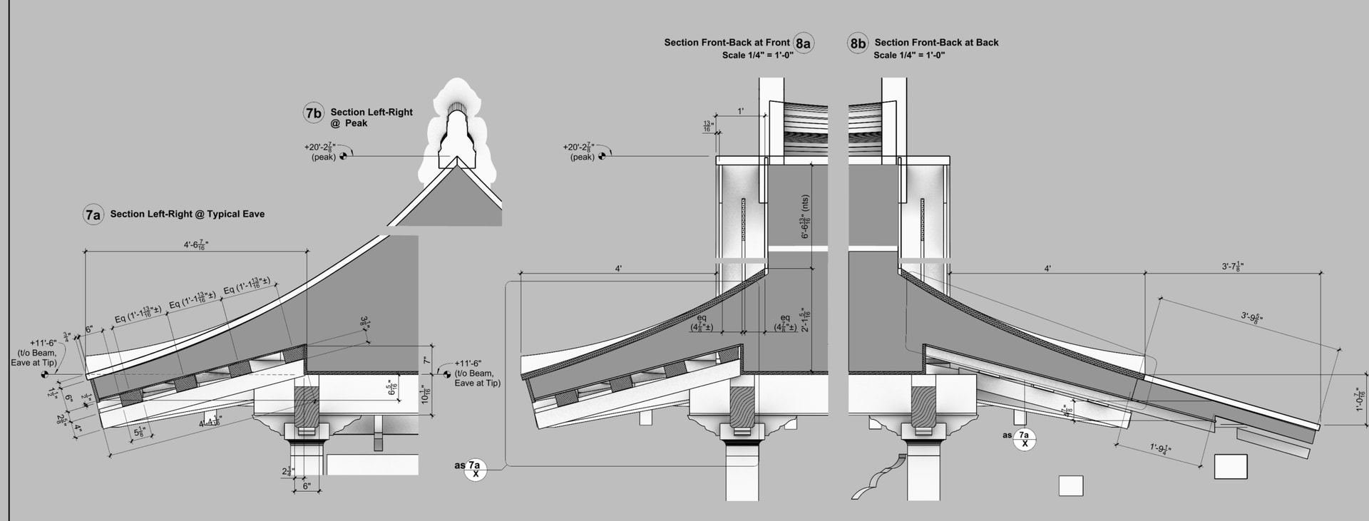

Thank you for providing the file, it works normal on my end, as shown below

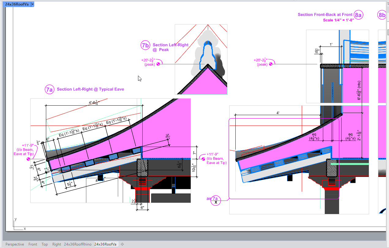

I’m not having success with either Rhino or Va in displaying section fills in details for all of these objects, some of which are in blocks and some aren’t.
At the moment, some of the Section styles set in Rhino are showing up in the detail windows (though clipping planes are disabled and Va Section are active instead) and as set in the Section attributes panel. I’m not sure how to manage this when switching between the two applications’ fill management systems.
Because I’m having intermittent issues with blocks disappearing when selected unless Va is disabled, I was attempting to manage this without Va. However, Rhino 8’s section styles seem to behave unpredictably in blocks, so I’ve switched over to Va where I’m facing this confusion of active Rhino section styles.
As is visible below, many objects are unfilled though their section styles are set to display. That’s the problem I was having with Rhino Clipping Planes and I have the Rhino folks looking into that. Now with Va sections and Attributes I’m not sure how to proceed to accomplish the same thing. I’ll email a link to the project.
With Va disabled the section styles display properly in Rhino. This seems to point to Va being the problem.

I’ve got your file. I open it, and I can see all section styles in the geometry. VisualARQ is enabled:
Using R8 sr24 and VisualARQ 3.6.2 as well.

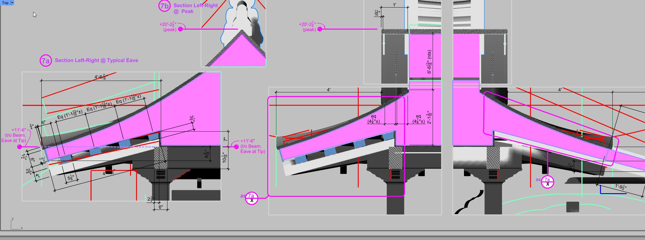

Section styles seem to work in all details of your two layouts. They are all using clipping planes. If I switch to VisualARQ Sections, the section styles are displayed properly as well:
Am I missing something? Is this a display issue, or a printing issue?

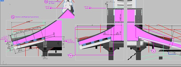

Are you having this issue with other display modes? Can you try it with the “Hidden” display? or with a Rhino display mode reset to defaults (in case you have changed an setting)?
VisualARQ 3 uses the Rhino Section Styles. So you should see the same when you see an object in section and you have assigned the section styles to the object from the Rhino section styles dialog, or from the VisualARQ’s “Section Attributes” section in the Properties panel. They are both synchronized. The main difference is that VisualARQ adds a “Print Width” and a “Print Color” attributes which are missing in the Rhino Section Styles dialog.
