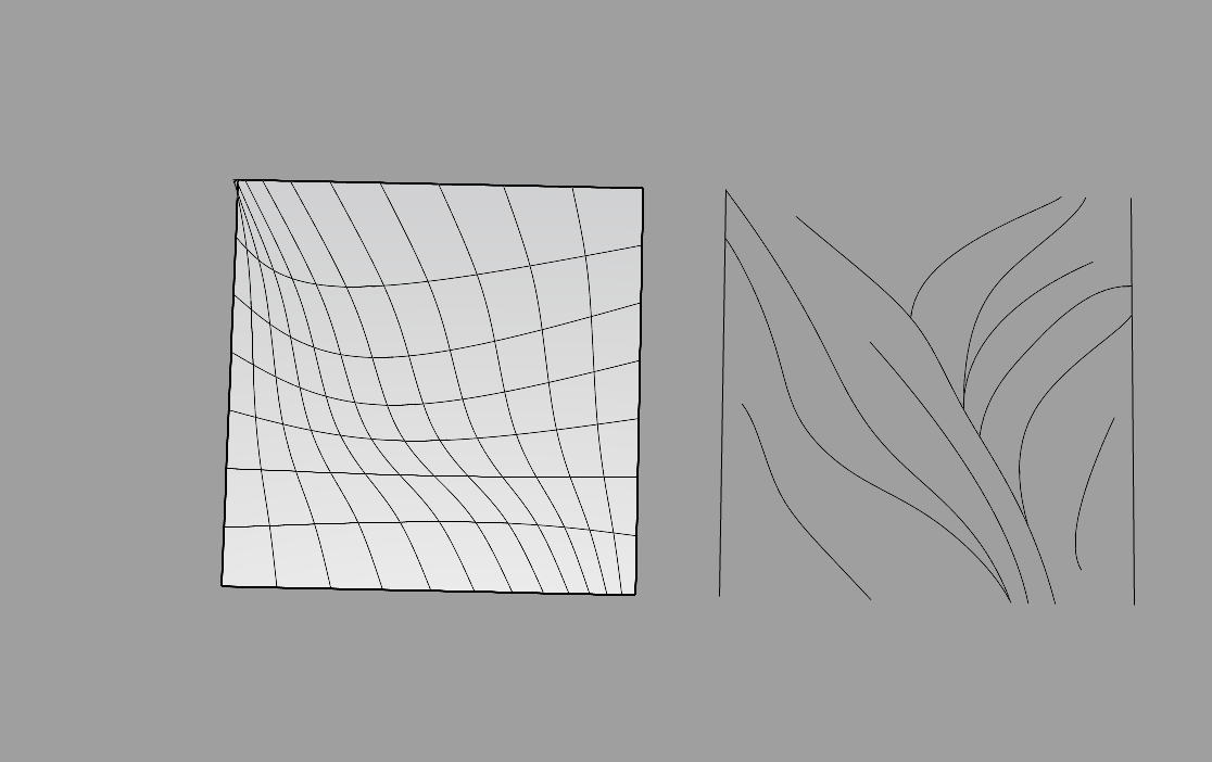

I’d like to achieve this geometry to later perform the CNC milling.

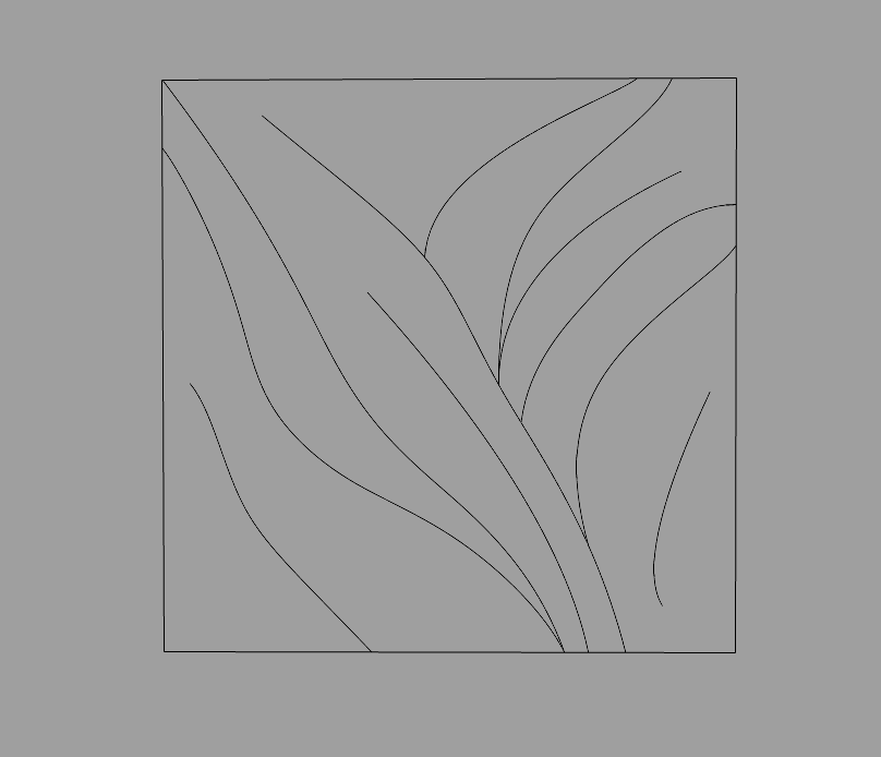

I only have the following curves drawn in a 50x50cm box.
I would like to reach a result like this:

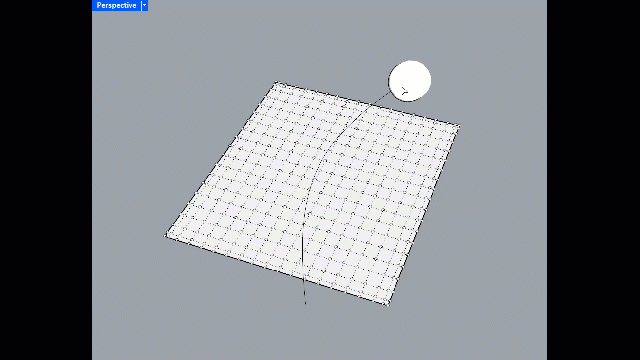

You could play with the Align command, using option “to curve”.
I learned this long ago here.
In addition to it, I’d select the area via the SelBrush command, then deselect the attracting curve, running align and then (optionally) smooth afterwards:
2025-06-18_15-38-52

your curves are creases, then add edges as per rule of three to get your transitions.

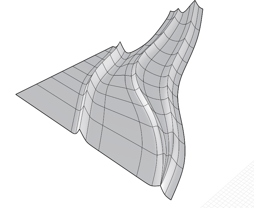

see below- and attached file for a quick and dirty example, feel free to steal and make your own adjustments and refinements.

couple of ways, make subd friendly curves and extrude them in both directions to get your basic shapes, then stitch the verts together or bridge edges to connect them, bridge or stitch to fill in the blank spots.
or, you can do what I did and start with a single face, and then simply drag the points to match your shapes,

this is the basic structure you are working with-
one curve, (subd friendly) extruded 4x,
pull up the center most curve and crease it.

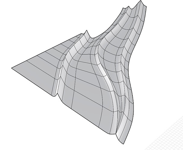

start with extrude all those curves individually 2x from the center (4x total) even if they overlap.
pull up the center edge and crease to make all your “spines”
you’ll be left with a bunch of individual parts that you need to connect.
you can stitch edges together, or bridge between the pieces, or delete faces and stitch the remaining ones to others.

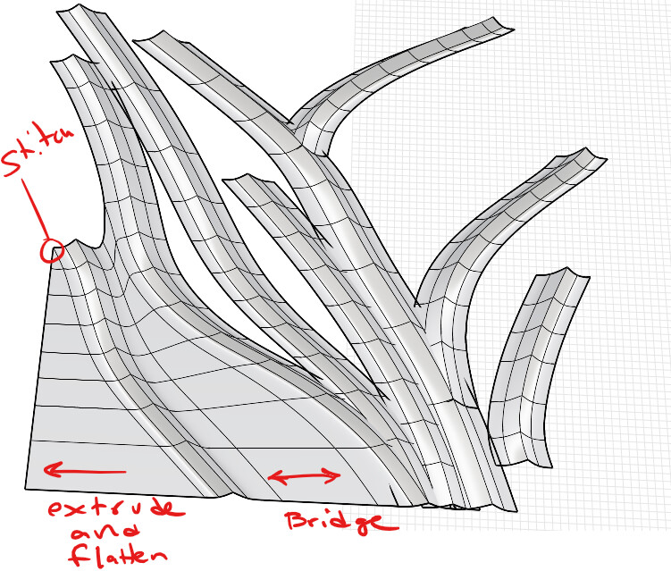

your next move now is to start connecting everything up-
remember model in box mode, adjust and refine in smooth mode. It’ll keep you more organized and the model will be easier to control.
just knit up the post it notes… delete edges when you have too many, add some when you need an extra.
Bridge needs the same number of edges, so you can do it a bit at a time and sort out your edge count as you go.

take a peek at this.
you have to delete the overlapping stuff then bridge and stitch stuff.. it takes a bit of back and forth to get it right.

bridge requires a matching number of edges.
so lets say you have a mistmatched edge count. Bridge what you can then extrude and stitch what’s left over.
