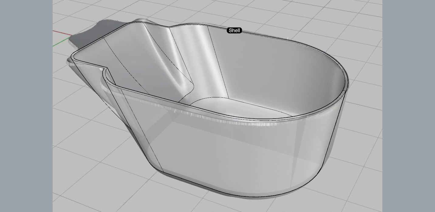

you don’t need that amount of curves, you can build the model with few curves and extrusions.
Basically what @JimCarruthers and @DiegoKrause are suggesting to you is true. Your model is fairly simple and you should be able to model it using a combination of curves and extrusions. If this presents a challenge you can use Contour to get a model that is close. When I use Contour I set a much wider spacing and add details later. But in the long run it would be much better to model in a more traditional way as you will increase your understanding of surfacing.
something like this:
