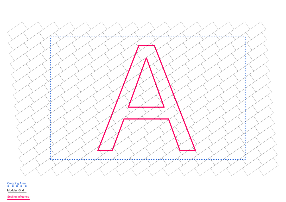

I am trying to recreate this in GH (Using Rhino for Mac):
This is just an explanatory sketch, but It gives an idea of what I am trying to achieve.
  1. I would like to be able to have a grid of rectangles I could rotate and choose the rectangle dimensions.
  2. On top of that I would like to influence their scale when the area of each rectangle has more than 50% of it within the typeface boundaries. My experiment aims to build this on paper.
  3. Extrude them (the extrusion influenced by the A boundaries too). Having two values on the rectangle dimensions. One extruded rectangle with X value when they are outside the A and one X+ something when the are of those rectangles are within the A (Area of the rectangle needs to be >50% within it).

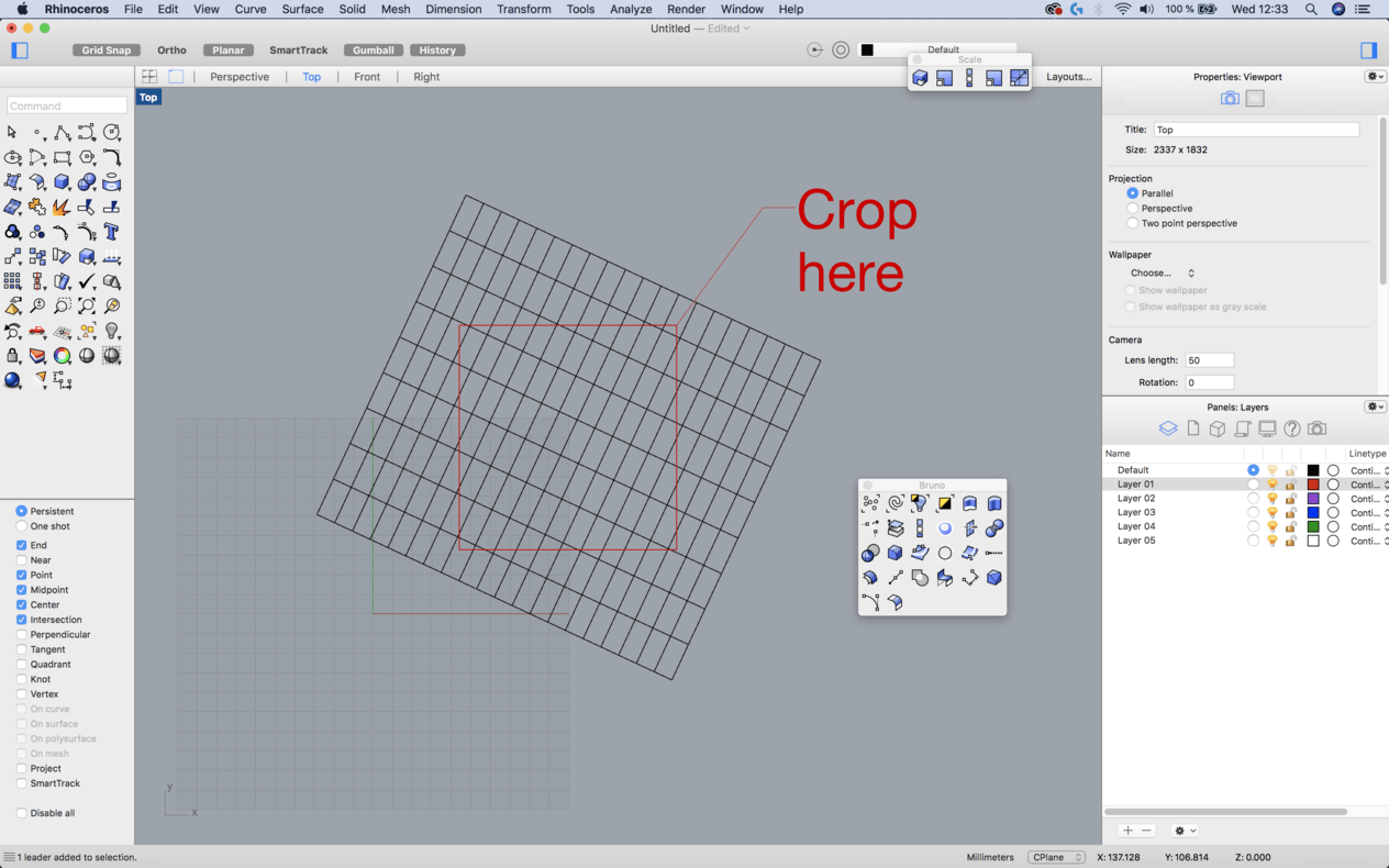

  4. Crop those volumes where the dotted line is.
After understanding these questions I would like to proceed to extrude them in order to have volumes and be able to make this in paper :slight_smile:
Thanks a lot for your time.

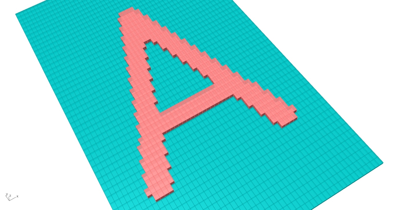

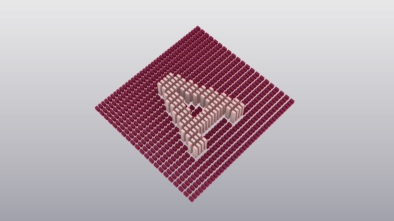

something like this?
Let me know if this helps!
Cheers,
Patternseeing
This is totally what I am looking for, but I am trying to avoid the overlapping when you rotate the modules.
I am not sure if this is possible. Thanks so so much for your help, I am trying to replicate it by following the screenshot :slight_smile:

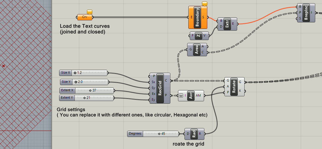

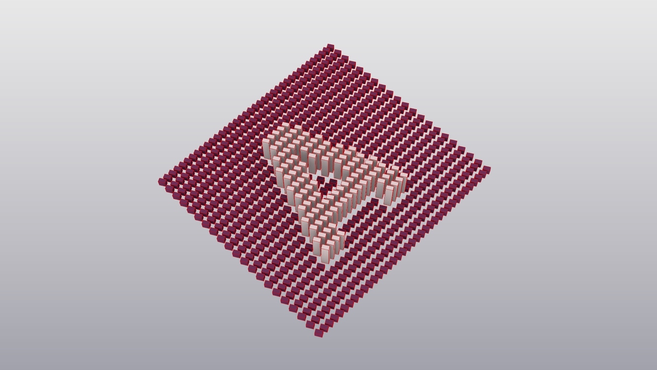

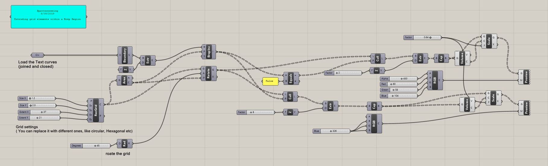

Cool!
I made a small update to avoid intersections
Here you have the GH file!
TEXT_EXTRUSION_patternseeing.gh (16.9 KB)
:v:
Cheers!
patternseeing

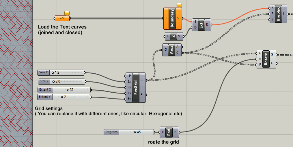

You didn’t internalize your curves? And from what I can tell, you would be better off rotating the ‘World XY’ plane input to RecGrid instead of the individual cells later?
Or rotate the whole grid? That grid is not the brick/parquet floor pattern specified?

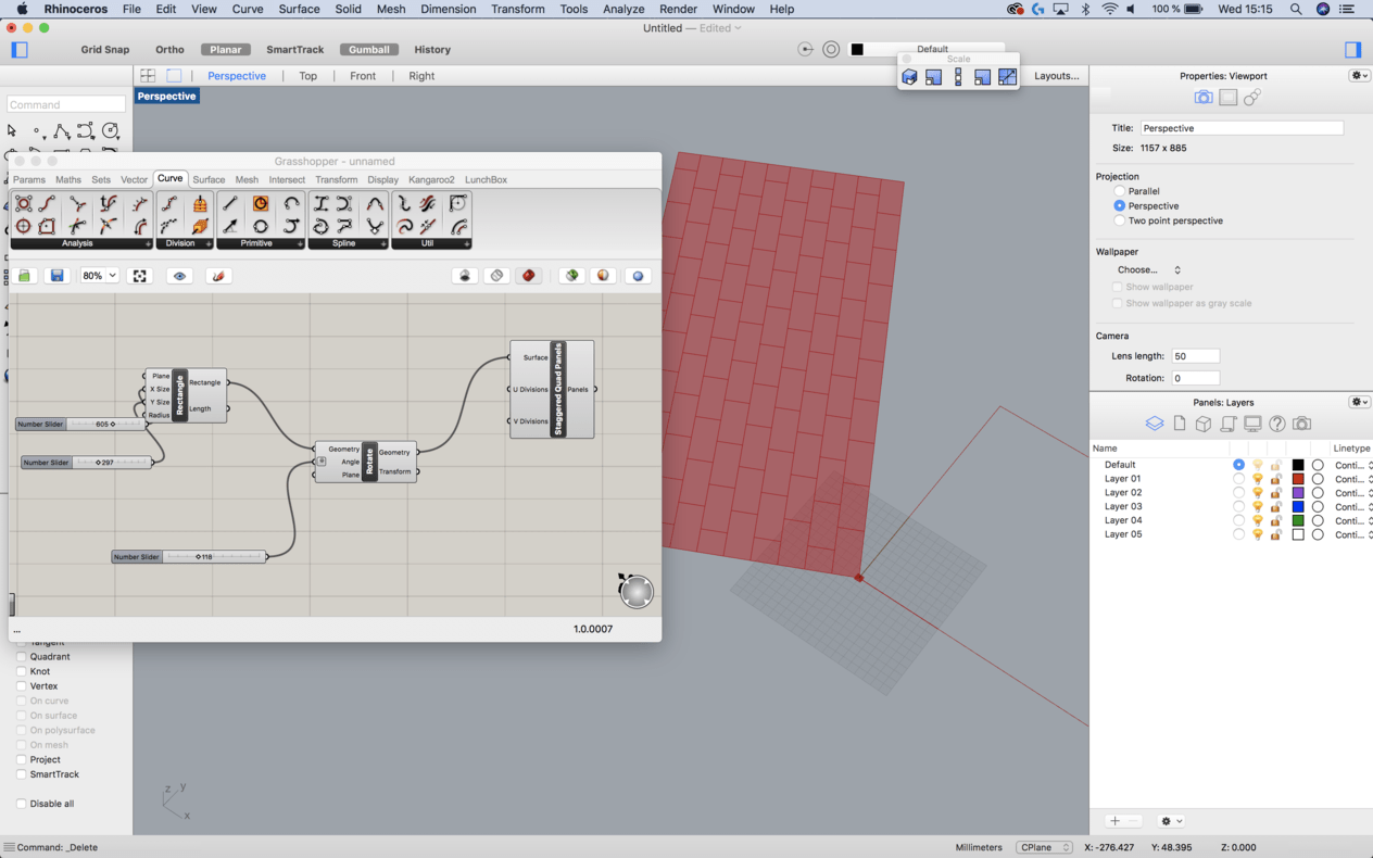

I tried to start from scratch.
I am getting a little bit frustrated.
I can not even rotate my rectangle from the center of the scene.
Thanks

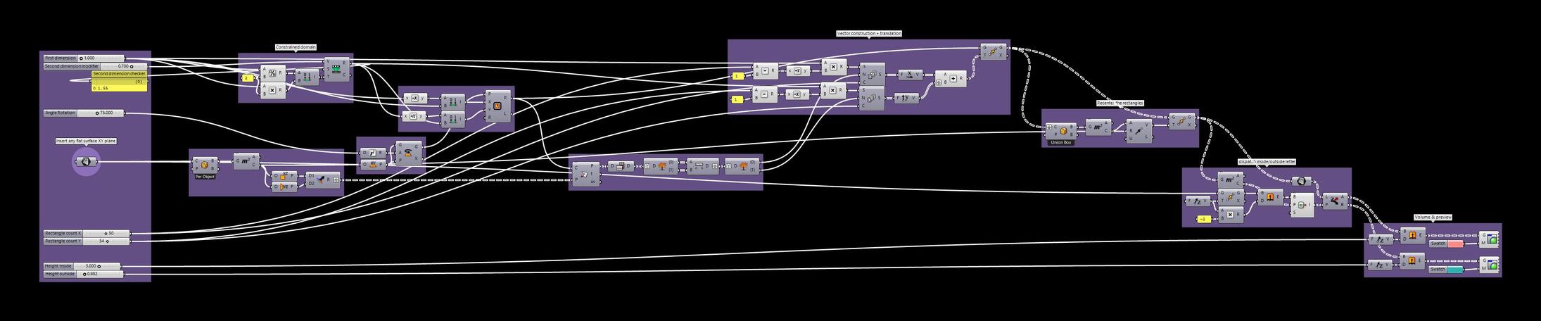

But for your last question, grab the area of the big rectangle, and plug the center point in the “plane” input of Rotate component.

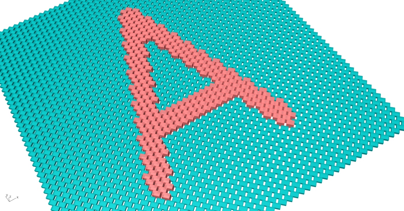

Is this what you’re looking for?
Note that in order to avoid collision, at least with this method, the second dimension on the rectangles have to be constrained a bit.
To modify the first dimension, simply enter it the slider “first dimension”.
To modify the second one, you have modify the slider from 0 to 1 (and check the panel that tells you the length of the second dimension of the rectangles.
NotCollidingRectangles_AMA.gh (27.8 KB)

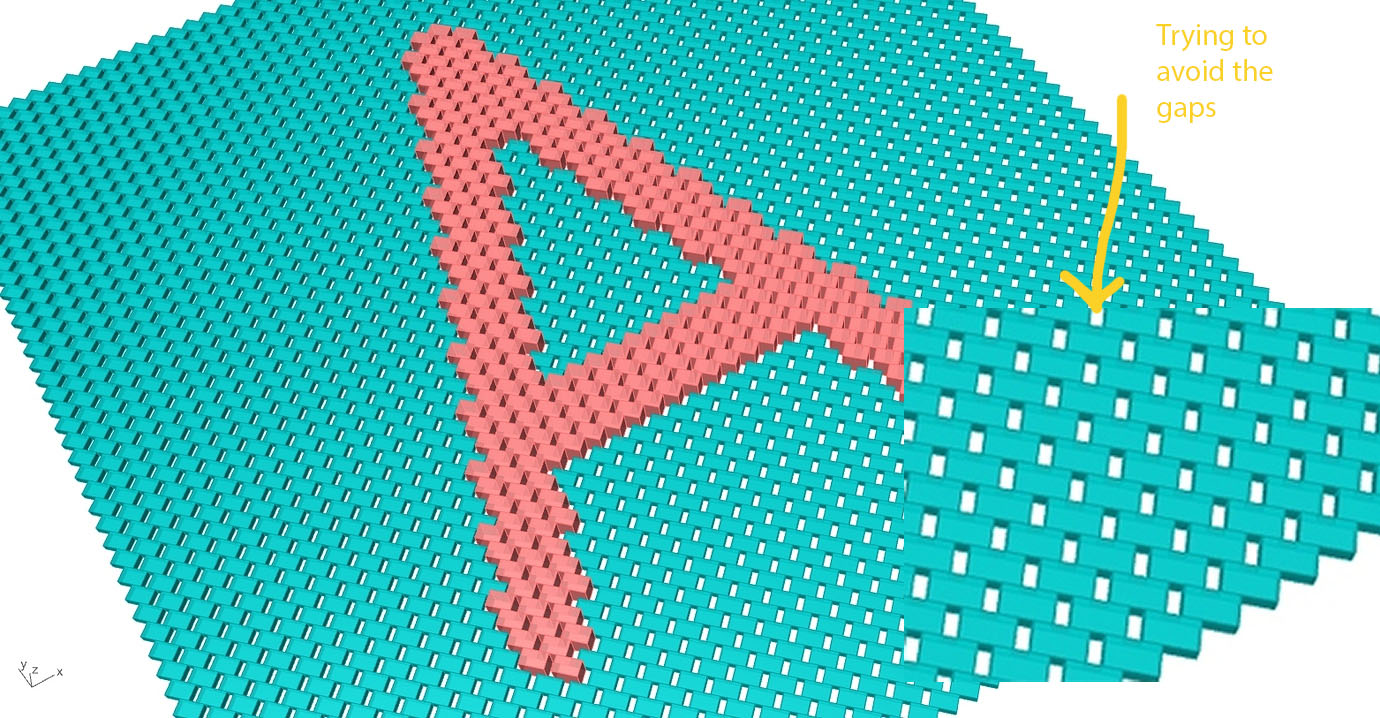

Thanks so much @antoinemaes for your help. I am actually trying to avoid the gap between the volumes. Please find attached an explanation:
I’m afraid that is actually impossible to achieve with predefined rectangles.
Dimensions would have to adapt as the rectangles rotate, even becoming squares at some point to avoid these gaps.

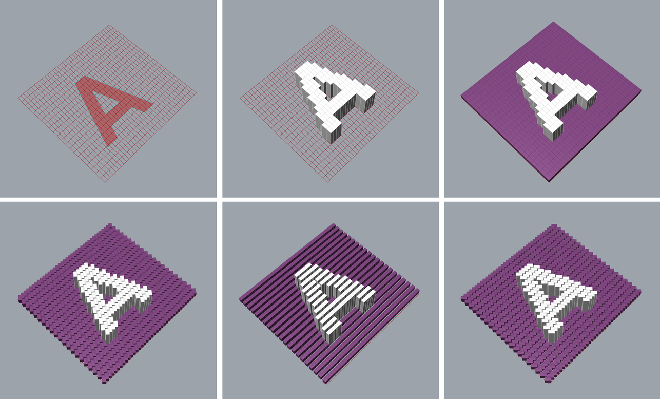

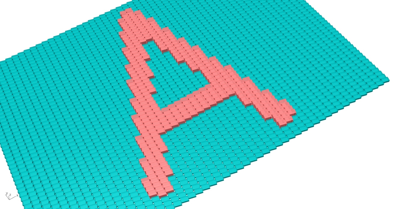

mmm I am thinking just in this simple solution:
Just rotating a grid while cropping the desired area.
Like this?
You can choose to crop or not (it becomes quickly heavy)
NotCollidingRectangles_2_AMA.gh (19.6 KB) NotCollidingRectangles2
