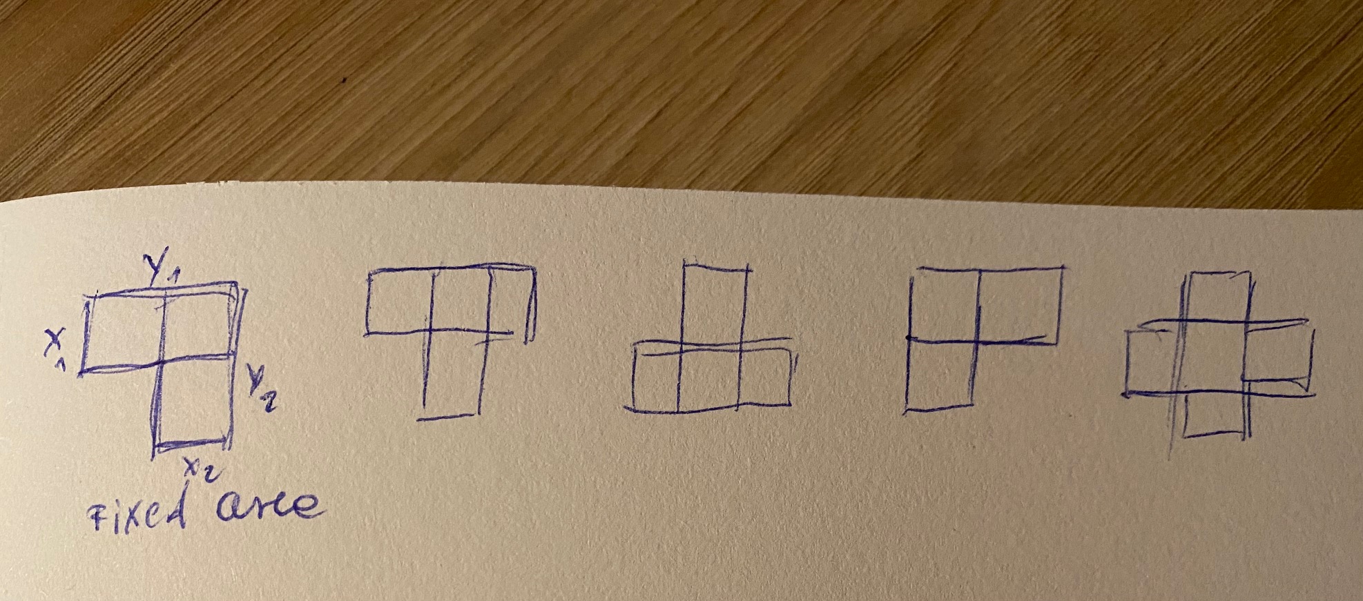

I am trying to create a script which creates random building shapes composed of 2 rectangles like in the figure below:
I would like to keep a fixed area of rectangles, change their width and length and move rectangles maintaining their intersection.

In your sketch, all cell clusters are composed of 3 or more “squares”?
Will the individual cells remain squares and aligned grid-like like in your sketch or wildly change in size and proportion, making some or all polygons or rectangles?
The moving part is not really an issue, since “growing” clusters might be more appropriate here, meaning that you start from a cell and append appropriate, matching neighbours.
Sure, but you should make up your mind about what you want to do and establish some rules.

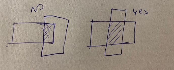

What does “fully intersected” mean? Do two sides of one rectangle need to intersect exactly two of the other one? Is overlapping allowed and seen as “full” intersection?
How do you want to change the state of the configuration? Do you want to play around with a single slider or get a certain number of possible permutations?

I would like to have two rectangles overlapped. Please see the schema below:

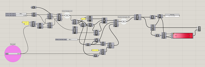

I’ve started with the creation of two rectangles. So far you can change their dimension, keeping the fixed area of each. Now I need to apply a rule to move them and change their position.
It doesn’t matter if one or more sliders are used to get a certain number of permutations.

Shape L_1.gh (14.4 KB)
I think I found a solution. I am not sure if it’s the most efficient way to achieve what I want…
Maybe you can suggest me a better idea:)
Many thanks!
Shape L.gh (29.9 KB)
