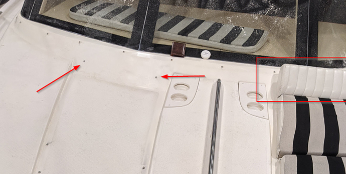

This is probably a simple question. If I needed to “rotate” this to the c-plane so I can plot on my CNC a pattern, what is the best way to do this? I know how to use rotate, but I’m thinking something like this in the screenshot.
This is a boat sunpad cushion and the raised “dots” are snap positions where the head rest is hinged on the cushion. I need to 2D this so when I pattern it, the snap positions are accurate.
I figure if I make a rect outline, I can rotation in relationship to that edge. Hope this makes sense (=

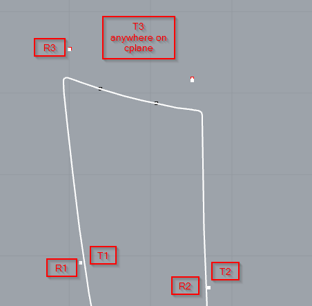

have you tried using Orient3pt?
I use that when I need to normalize the whole capture to the plane. If I use that for this small section, I still need to tell it where to go, right? I need 3 reference point, then 3 destination points which could be anywhere. BUT… hmm… if I reuse the two points from the drawn line and the 3rd on the plane, that may work. Is that what you were thinking?
I dont think that would work unless I’m not doing something correctly. I’ve attached the model to the post if you want to mess with it.
I’ll have to play with this more in the morning. This might work but I think order of reference and order of targets matter. It also appears I can only do one “point” at a time.
If I change the order around the new point can either be WAY off or if I do it in another order it offsets like an inch or so which is expected for a rotation arc.
Red is the new position which may or may not be right? /sigh (=

If you want the “hinge” line to lie along the edge of the in-plane piece then you will have to twist the two points, i.e. rotate one more than the other.
I would use Orient3Pt with Scale=No with three reference points on the object and three target points on the CPlane.
The first target point determines where the oriented object will be located on the CPlane.
The second target point determines how the object will be oriented on the CPlane. It’s distance from the first point does not matter, only the direction from the first to second points.
The third target point needs to be on the CPlane. It cannot be colinear with the first and second points. Which side of a line from the first to second point the third point is on determines whether the result appears to be “right side up” or “upside down”. Otherwhise the location of the third point does not matter.

Result using Orient3Pt: CushionsDC1.3dm (90.3 KB)
Use of Orient3Pt (Blue scribble shows location third reference point.)
Orient3Pt will yield the same results in this situation.
