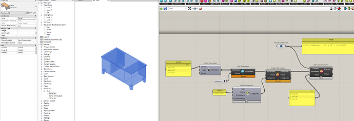

Good day, how can l add a multiple instance parameters for a revit element?
Thanks
Hi Sketzjewel, Here’s the process of creating the parameter, adding a project parameter and adding the parameter to Revit Element.
Rir Adding Parameter to Revit Element.gh (10.0 KB)
This is also covered in our guide.

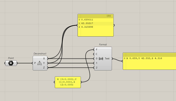

Thank you Japhy, how can l add a x,y,z coordinates as an instance parameters? Thanks.
If you have a point you can deconstruct and format it into your text for your instance parameter.
