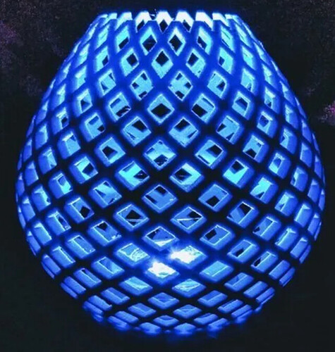

Hey!
Does anyone have any idea on how I could possibly create this effect in Grasshopper? I am aware that it is possible to create custom G-code and possibly achieve it that way. However these are 3D printed and sliced with a standard slicer, and i believe printed in vase mode as well. I am really struggling to figure this out.
If anyone could help me out I would greatly appreciate your help, thanks in advance!

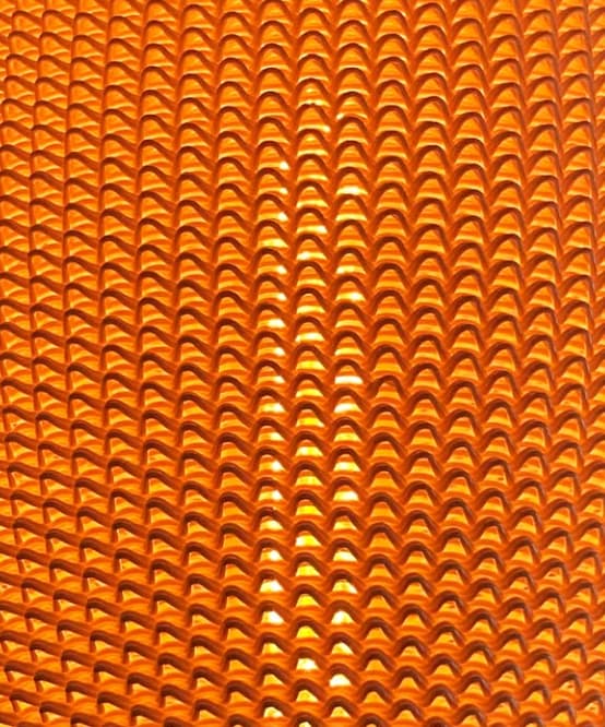

Yeah that is cool as well, not exactly what I’m looking for. The process of making it is a bit clearer here, the texture can then be scaled down
That looks like the method for creating g-code paths to give the effect in the picture, rather than actually modelling the shape as it looks like lots of separate shapes stacked on top of each other instead of one continuous surface or mesh.
Try this…
It is using some script to create the mesh from dividing the initial profile curve and arraying the points.
The script is from this discussion… https://discourse.mcneel.com/t/construct-mesh-from-rectangle-vertices/190650/7
Then it gives alternating +ve and -ve distances to stellate the mesh, one face inwards, next face outwards and so on.
Bobbles.gh (11.7 KB)

I know that in this specific instance he models the shape and export it to obj and use that in standard slicer software, which I’m trying to do as well, but will probably look into gcode generation at some point
Yes, my example does exactly that… creates a closed solid mesh that you can export as .OBJ or .STL and import into a slicer.
You can change the thickness of the mesh so it works for vase mode slicer settings.

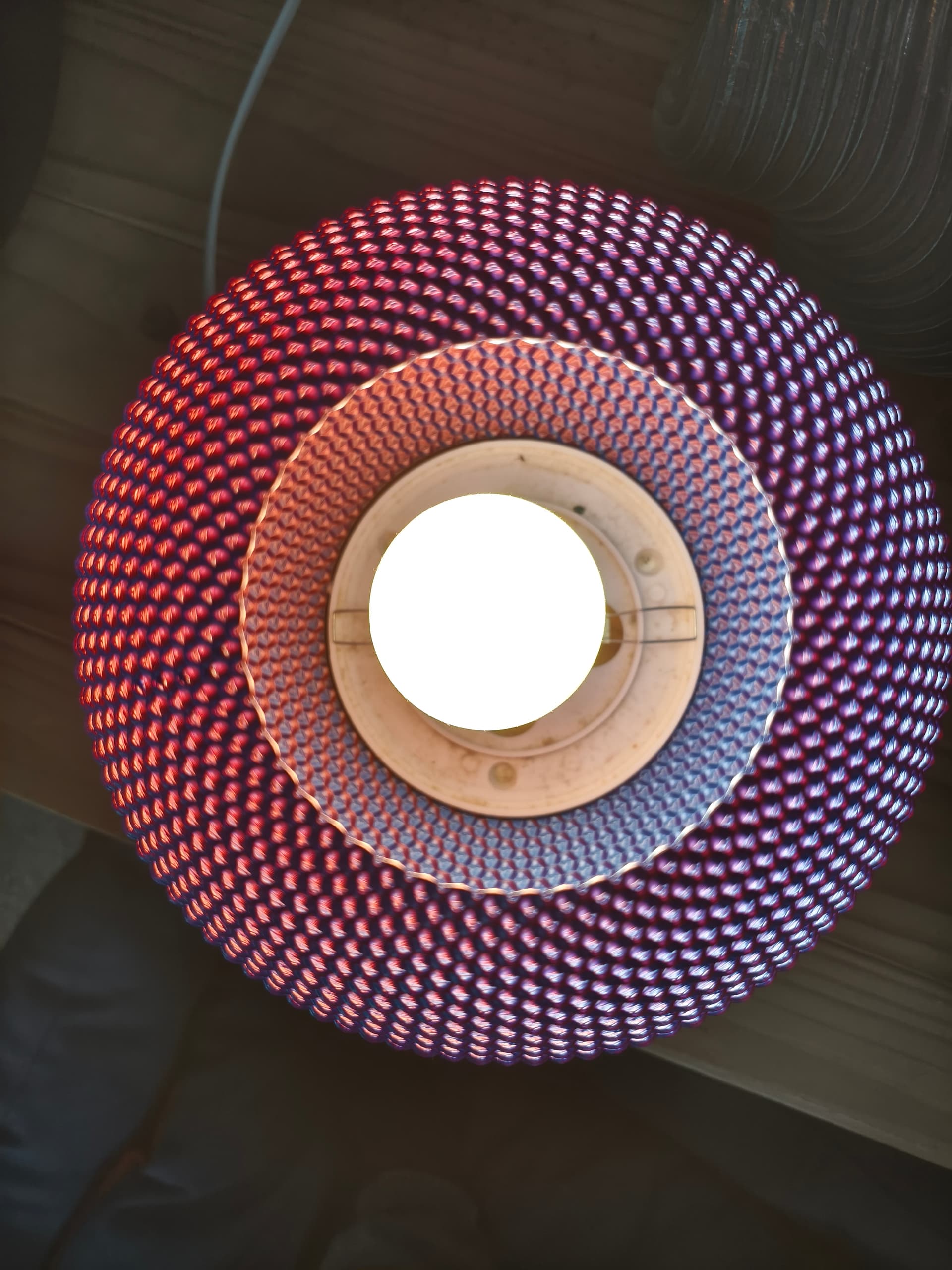

I’m tempted to print one to see what would happen… with the bobbles set to protrude too much the overhangs are too much but it might create an interesting effect… or spaghetti :slight_smile:
EDIT: I noticed a slight error… one slider needs to be odd only and the other even only…
Bobbles.gh (13.8 KB)
It’s interesting. Not sure it’s going to make the IKEA catalogue though :grin:
It becomes transparent where the overhang means the filament overlap is too sparse and leaves gaps. A quite fragile lampshade.
Filament is a bi-colour PLA Silk printed in a Bambu P1P in 4.5 hours in smooth vase mode.
