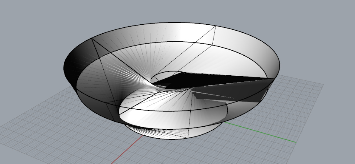

I am trying to create a command for curve revolution with RhinoRevolve.
This is the part relative to the 360revolution:
const ON_Curve * crv = ON_Curve::Cast(obj->Geometry());
if(crv) {
	ON_Line axis(ON_3dPoint(0,0,1),ON_3dPoint(0,0,0));
	ON_Interval interval(0,2*ON_PI);
	ON_Curve * crvd = crv->Duplicate();
	const ON_Surface * crvRev = RhinoRevolve(crvd,axis, interval);
	if(crvRev)
	         context.m_doc.AddSurfaceObject(*crvRev);
It seems to work fine for interpolated curves but it fails for some polycurves (and it even lags few seconds),
whereas Rhino is capable to do it in the correct way.
I wonder if I am using the right function.

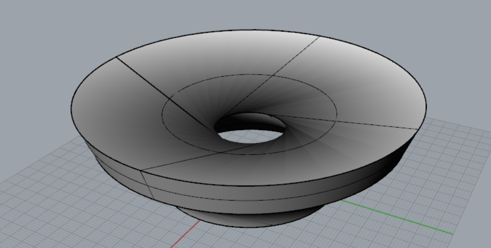

Hi @gennaro,
See if this example is useful.
– Dale
it seems to be the right solution…
Thanks!!
