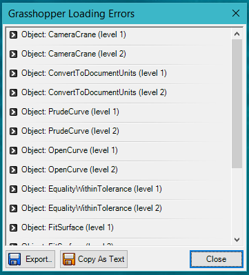

-I got this Grasshopper error window each time I run Rhino 6.

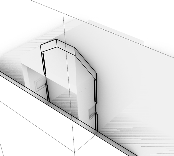

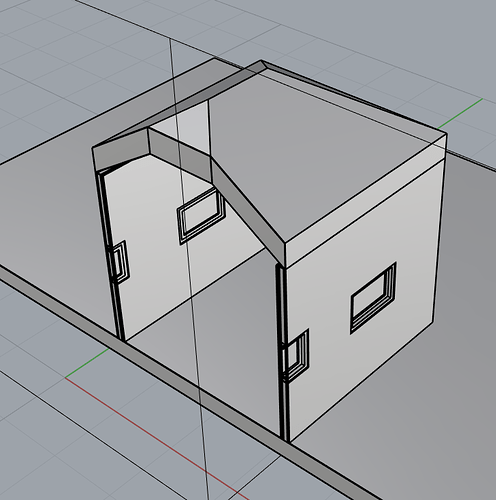

-The Hidden Display mode isn’t really hidden as I can still see the grids in VisualARQ Objects.

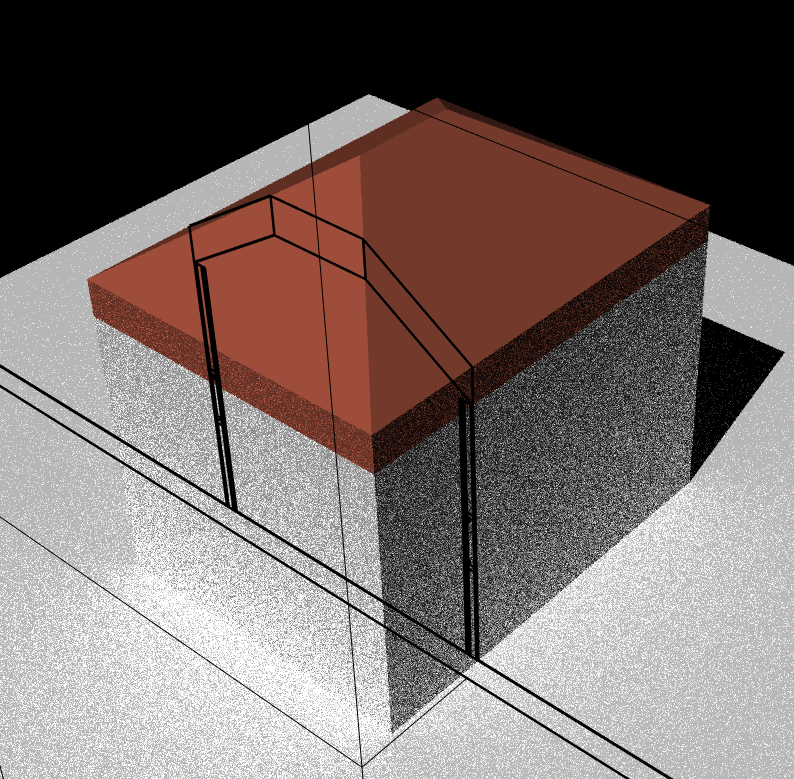

-Raytraced and Render mode are way worse than it used with VisualARQ Objects, plus it hangs many times in Raytraced mode.

I’ve installed the same version of Rhino 6, and I don’t get these errors. There is another user that has the same problem (Grasshoper Error when open rhino 6), and he has some Grasshopper add-ons installed. I think that maybe VisualARQ Grasshopper Components have some compatibility issues with one of them. Can you please tell me which GH add-on do you have installed so I can try to reproduce the issue here?
This is really strange. VisualARQ 2.1 should be as fast (if not faster) on Rhino 6 than on Rhino 5. Does it happen when working with VisualARQ documents or with any kind of document? Can you describe what is slow? The display? Running commands?
What do you mean by “just stop running”? Rhino windows closed without showing the crass dialog?
Do you have a document where you’re seeing this error? Does it happen with all documents? Does “Technical” diaplay mode work fine?
Yes, we’re aware of a problem related to the Raytraced display mode, and we’re currently working on a fix. Rendered display mode should works fine, and even better than in Rhino 5. Can you show what problems do you see in Rendered viewports?
I think this problem may be related to the Grasshopper errors you’re getting when VisualARQ / Grasshopper loads.

I don’t see any problem in this image. Do you mean that you’re seeing the viewport grid over the objects? If yes, this is not a bug, this is on purpose.
Hidden (and Technical) display modes hides lines from other objects, but not the grid.
This worked the same way in Rhino 5. “Technical” display mode in Rhino 5 also shows the grid, but in Rhino 6, grid is disabled by default. You can enable it under the “Display” tab.
Sorry, I don’t understand the problem, as the capture seems fine to me. Can you please try to describe it? What is not working? Is there anything that is different when using VisualARQ objects or Rhino native objects?

Hi Enric, I believe it has something to do with Vray for Rhino 6. As I removed all the adds-on except Vray, and I still got the error window. However, when I unloaded Vray, to see if VisualARQ will start normally. I ended up with Rhino 6 crushing every time I attempt to start Rhino 6. I sent the error report to Mcneel. Now how can I solve this?
I highly doubt anyone at McNeel will check this error now. Can you please zip and send me to visualarq@asuni.com the “RhinoCrashDump.DMP” (not 3DM) file that will appear on your desktop when you try to start Rhino 6? Take into account that this file will dissapear when you close the report dialog, so rename it or make a copy before closing the dialog. I’ll check it and see if I can tell you what’s going on.

Hi Elshariff,
According to the DMP, the crash is happening inside the code of a DLL called “VRaySDK.Net.DLL”, which I think is from V-Ray.
Did you uninstall V-Ray or you disabled it in the plug-ins panel?
If you disabled it, I think that when Grasshopper tries to start, it tries to load the VRay add-on, and as the RHP is blocked, the add-on may fail to load and crash.
I’m now downloading V-Ray 3.6 for Rhino 6 and I will start investigating why VisualARQ is incompatible with it. I hope I can solve the problem this weekend, but maybe the fix will need also changes also from ChaosGroup…
In the meantime, if you really want to use VisualARQ under Rhino 6, you can try to rename the V-Ray addon .GHA file to .NOGHA, so Grasshopper will skip it when loading add-ons.
Enric

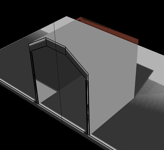

Hi! I dont know, if this is relevant comment here, but I have just noticed a display error in rendered (and others) display views using skylight and shadows. There are some shadow fragments when using clipping plane. This happens only with VisualARQ loaded to Rhino 6. See picture bellow.

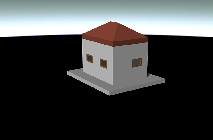

As @petumatr mentioned above, I don’t have the shadow fragments when using clipping plane, but I do noticed that VisualARQ objects appears to have some issues when using clipping plane in some display modes:
-Raytraced display mode: Clipping Plane ignores all VisualARQ objects.
Arcitic Display mode: Clipping plane does cutting through the VA Objects, but it ignores some.
Rendered & Hidden Display modes: Clipping plane does cutting VA Objects but it appears to be like a mirror I don’t know.
The other display mode are just working fine displaying the cutting objects.
Just a quick note on Raytraced, that display mode doesn’t support clipping planes as of yet.
