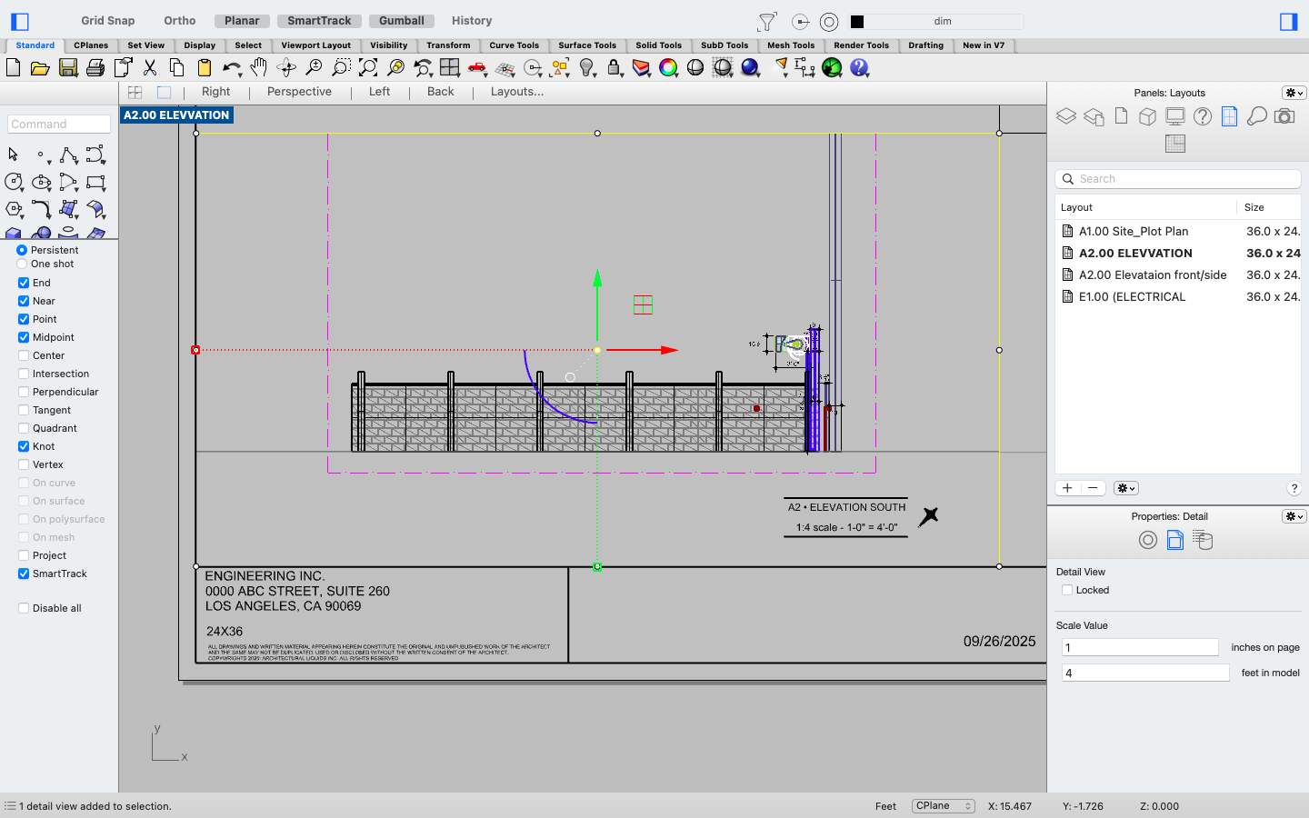

Yes I understand this but you’re still not fully answering my question. Let’s use another example let’s say I create a rectangle in the model 24”x36” then to match my paper size I would scale the rec up to 48 in the model to set a paper border for a detail let’s say! So my drawing in model seems to fit 1:48 very nice. Then I go to the wonderful rhino layout I make a 24”x36” to match my model rec I double click in one of my detail squares and add the view I saved with my rec border and then click the detail to check the scale it says 1 inches on page and 4 feet in model….doesn’t this equal a scale of 3”=1’ if so why in Gods name does it give me that scale when my rec tangle that was scaled to 48 which would be a 1/4” is now smaller in the detail space and the detail is reading 1:4 this makes no sense…..is there a bug on my software I have no idea why I can scale up. 3’x2’ scaled up rectangle to 48 in model and then in layout it’s not even matching or scaling up to a full view layout detail space and is giving me a scale 2-3 x bigger going from 1:48 to 1:4? Am I missing something here or no one can see this? I’ll send a screen shot.

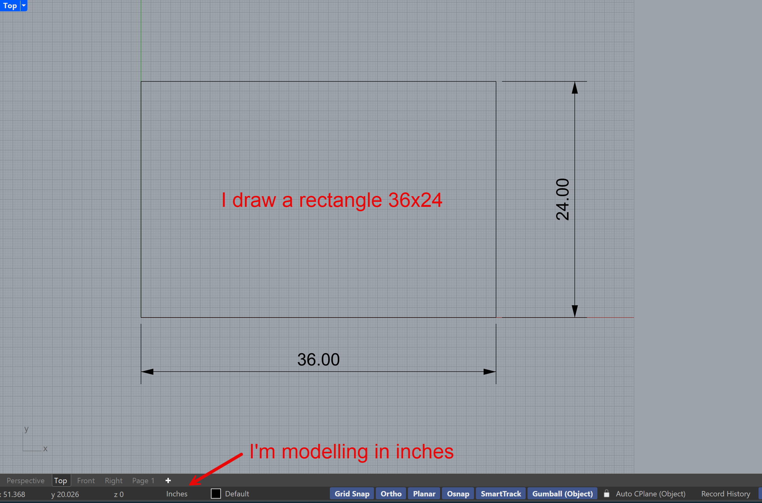

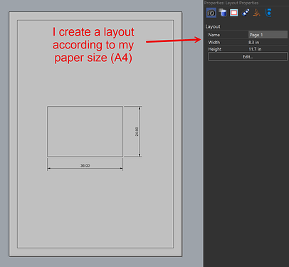

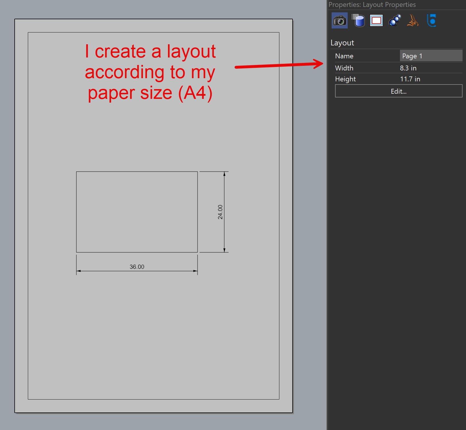

Hi Chad,
I get the impression you are overthinking it and applying unnecessary adjustments.
Here is the process I would use to draw a 36" x 24" rectangle at 1:10 scale:
  1. Draw in real-world units:

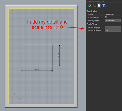

  2. Create a layout that matches your paper size:
  3. Place your detail and set the scale to what you need:

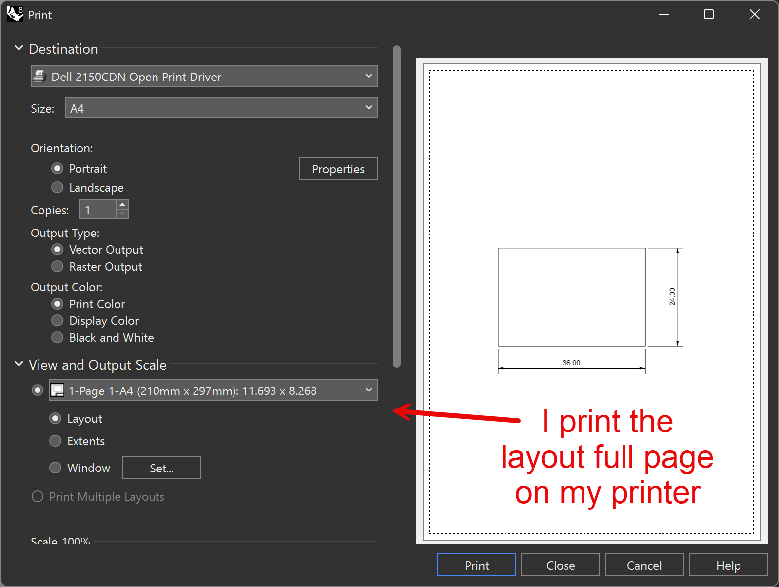

  4. Print the layout at full page size and with print scale set to 1:1:

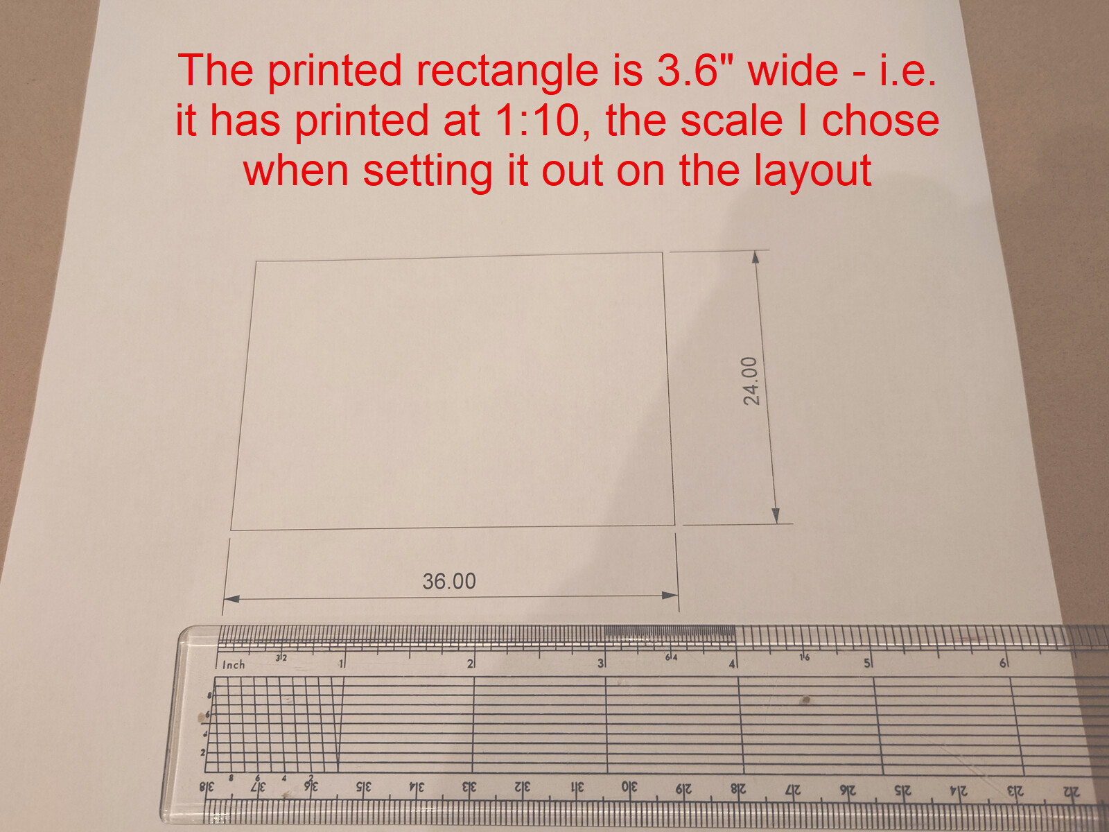

  5. Check the result:
HTH
Jeremy

Pay attention to the units in layout space.
1:48 without units, 1":48", 1":4’ and 1/4":1’ are the same.
Thanks David! Yea need to put my glasses on for layouts from now on! Thought I was in 4 inches :face_with_peeking_eye::nerd_face:! I was defiantly over thinking this!
