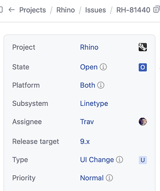

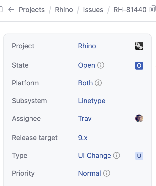

Our list of bugs and feature requests is mostly open to the public and we provide a link to the relevant ticket when someone reports a bug or requests a feature. This way, an interested user can check the status of any given item at any time.
This particular improvement request is currently open and on Trav’s list for Rhino 9.x:
