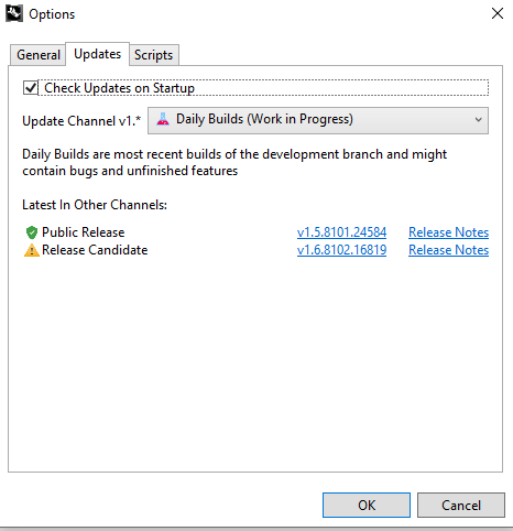

Where can we find this version? Is it beta? Do we need to install WIP?
In the options your can select the Public, Release Candidate or Daily Build.
https://www.rhino3d.com/inside/revit/1.0/reference/rir-interface#checking-for-updates
Thanks @Japhy
got it.
