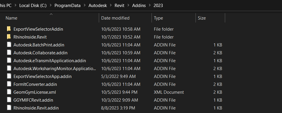

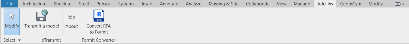

Hi, I have downloaded the latest version of Rhino.inside (dated 8.8.2023). But Revit doesn’t identify it; it doesn’t ask for permission to load it nor does it show up in the top ribbon next to the addins.
Btw I have Revit 2023 educational license and Rhino 7.19 commercial license.
I tried the solutions I found regarding fixing the addin path and Windows registry editor and I have the files in both program data and program files, but nothing worked :frowning:

Any idea what to do?

maybe a stupid question - did you try to uninstall RiR completely, start Revit without RiR, close Revit, restart PC, and then install RiR again?
Pavel
This is absolutely nuts :laughing: It worked!
Thanks, Pavel and Japhy you guys rock!
