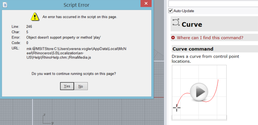

Clicking the embedded flash movies in rhino help leads to a script error under windows 10 (see attached picture, sorry for German error message).
Clicking to run the script, leads to the download of Adobe flash updater and to another error message telling me that Microsoft edge already contains the latest flash version.
This happens every time a movie in a help page is played for the first time.
Going to another page, then returning to a page where movies have already been played and replaying movies will initiate the whole thing again.

Sorry for replying late. I’m sorry that you are having the problem. Looks like you run Rhino in English. Please open the following location on your computer:
%LOCALAPPDATA%\McNeel\Rhinoceros\5.0\Localization\en-US\Help
Rename the RhinoHelp.chm in the folder to anything else.
Rhino will load the help content from http://docs.mcneel.com/rhino/5/help/en-us/index.htm that uses mp4 videos.
I’ll report the problem about flashplayer to our developers. Thanks for reporting this.

Hi @KelvinC
I just wanted to let you know, that your workaround did the trick.

Rhino 5 help documents (html files) were compiled into a chm file that we have dropped developing. Lots of html code editing will have to be involved if we want to make the chm to play local mp4 videos and we don’t know if it’s going to work.
I’m testing the problem on a fresh English Windows 10 and notice the flash videos in the help topics can be played. I have no idea why it doesn’t work on your computer and one of my computers. I’ll try to figure it out.

I noticed the flash videos can play if you open the RhinoHelp.chm outside of Rhino.
In the online version of the help, the Flash videos have been replaced with mp4. I don’t think I can do anything to fix the .chm file at this point. If this becomes a huge issue for people who do not have online access, we will have to do something to fix this, but for now, as stated before, if you delete the .chm from your computer (or rename it), Rhino will automatically call the online version instead of the .chm. Keep me advised of how widespread this problem is.

For Rhino 5, you can delete this Help folder
%USERPROFILE%\AppData\Local\McNeel\Rhinoceros\5.0\Localization\en-US\Help
Rhino will load the help topics online to the Help panel, or when you press the F1 key.
To read the help topics offline, you can download Rhino5_Help_en-us_mp4.zip
Extract the topic files from the zip file to a folder, and open the index.htm.
There is no other solution because Flash Player is no longer supported by Windows system.
