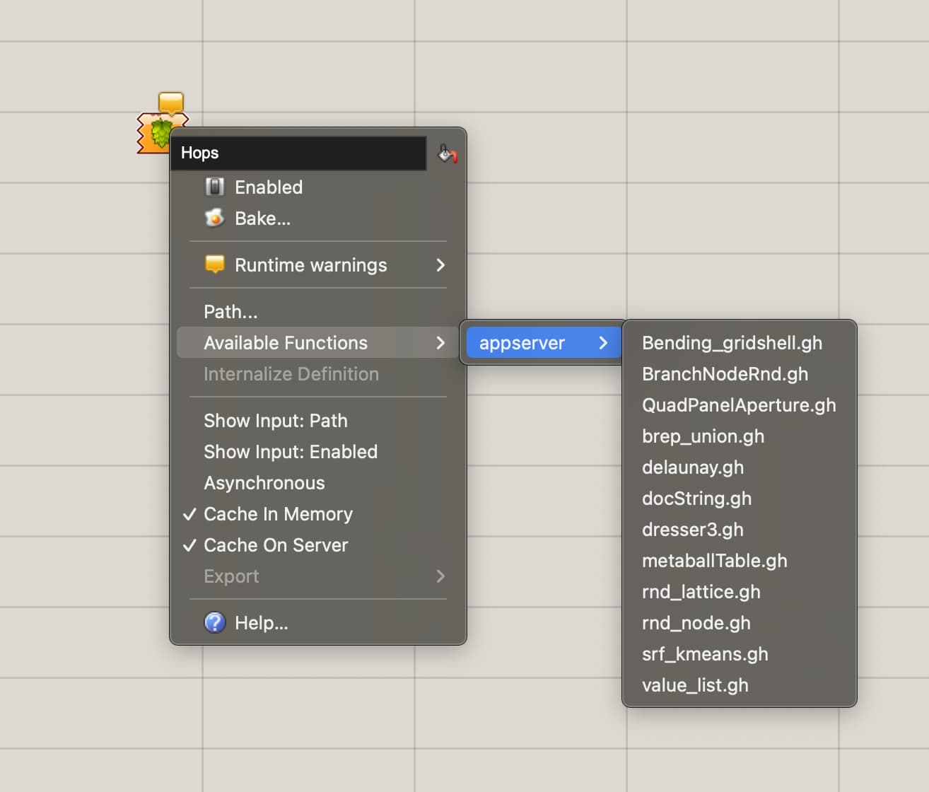

  • Appserver links used in hops will solve on the compute server associated with it. This screenshot is from Rhino for Mac. Rhino.Compute is not supported locally on macos, but I can still use hops with a remote compute server or an appserver connected to a compute server.
  • Providing an appserver url to GH will allow you reference them from the hops component (same as any remote location with some gh definitions)
