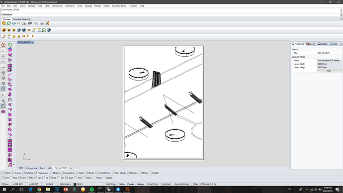

Does anybody know how to improve the PDF print quality ?

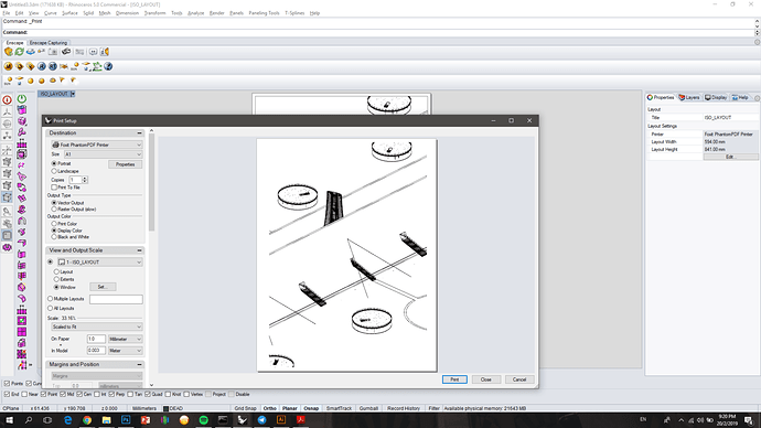

Are you sure you have Vector option checked on?
Second image - no, you don’t.
What about native Rhino PDF printer?
Have you tried playing with the properties (dpi) of the PDF printer?
This really helped improved the line quality. Thank you.
But I realised that by using this, the vectors will always export in Wireframe mode.
Is there a way to print vector output without wireframe?
You’d have to run Make2D, create a graphic, and then print.
Make2D was what I was trying to avoid… but thanks anyway. Good day.
