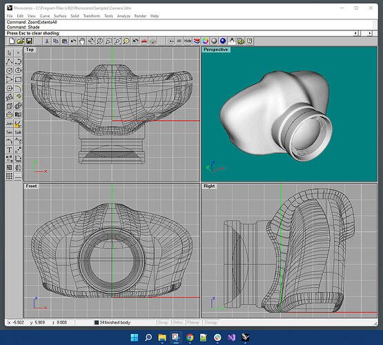

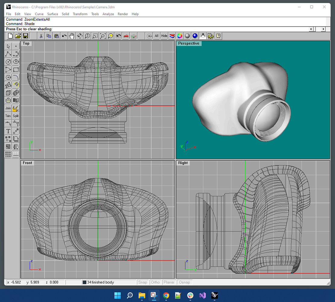

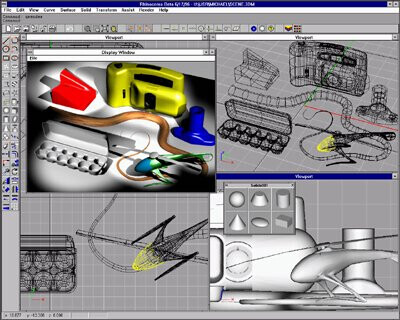

Looking back at the early Rhino interface (see screenshots below), one thing becomes obvious:
the ratio between button size and workspace area was different.
from: Nostalgia (Rhino 2) - #9 by dale
It changes over time when the resolution improves.
Buttons shrink into the background while the working area expands,
Today, there is more working space, and that proportion is lost.
On modern displays—4K, ultra-wide 5K,
and → soon 8K <—the default icon sizes no longer follow the original concept.
Request
Rhino needs adaptive, scalable button sizing that preserves the original design proportions across high-DPI screens.
