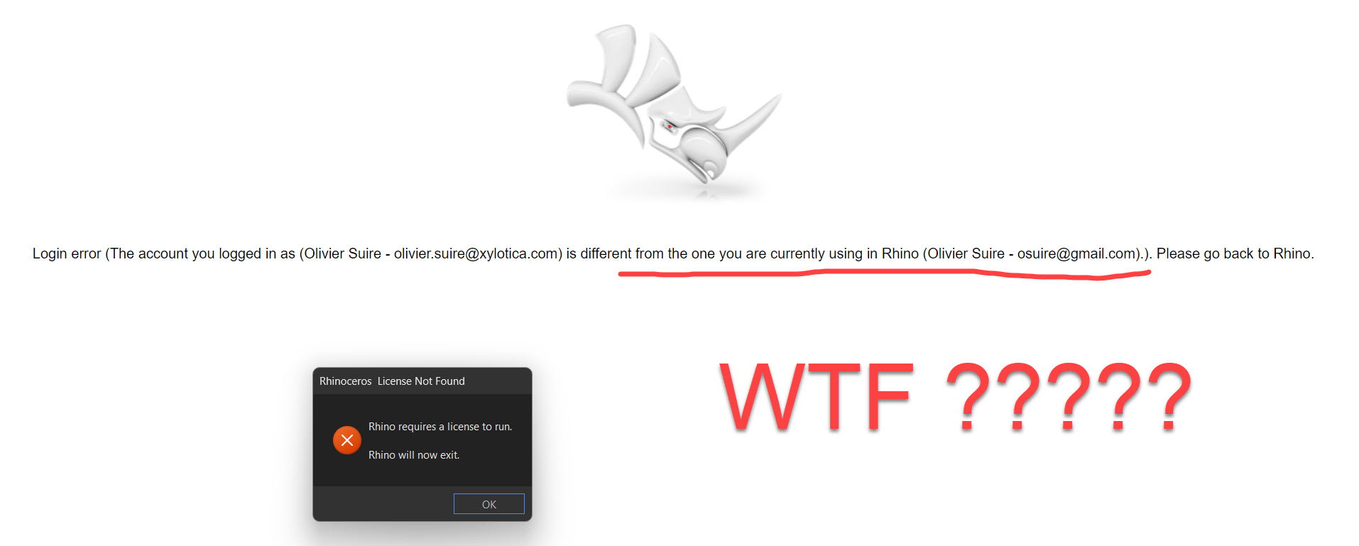

I recently upgraded to V8 and by mistake created a new Rhino account with my “pro” gmail address.
I was told to delete the old account and put all my serial numbers in the new one.
That was quite tedious already because my old Gmail address was on another Google account, and since the login process opens a new window, I kept getting lost and had over 11 links sent to my mailbox before I could finish the process.
But now, when I try to open Rhino (V7 or 8) I put my new E-mail, get a message saying my license was found, log into my new account and the I get a message stating that the account I logged in is not the one I am currently using in Rhino.
I suppose that my old account is cancelled, but some entry somewhere in a database hasn’t been updated properly.
And here I am fiddling around with endless loops instead of getting some work done.

Hi John, the part that doesn’t work is the one you see in the screenshot I sent in my first post.
It’s the part where I can’t use the software I paid for.

It appears you deleted a login account, then created a new account using the same email address. Since they are different accounts, that would likely explain the problem.
This is what I’m seeing. Notice the 8 digit account IDs are different?
Screenshot 2024-02-24 at 8.51.01 AM
My guess is the local license lease files on your system were not extinguished by logging out before you made the account change. That should have been a step in the process you were given.
If you complete these steps to manually delete the local lease files, you should be able to login and get Rhino running.
