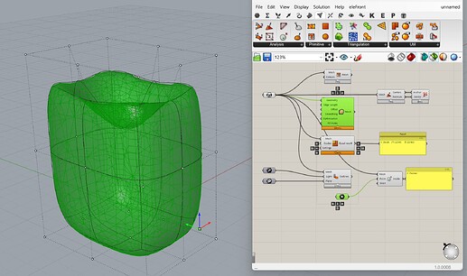

Note: is that a SubD edited with a cage? why ?
It has the control points enabled, is not cage edited on any way.
I tried to show that the point is inside the control polygon of the subD but is not inside the SubD itself.
