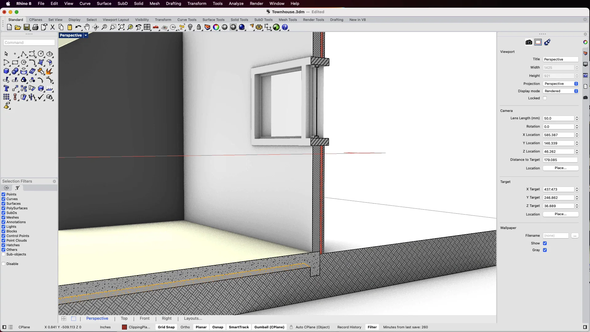

If i set a custom hatch by Clipping Section, that hatch does’t show.
After setting the ClippingPlane SectionStyle, you need to set the object’s SectionStyle to be “By Clipping Plane”. See this video that explain this workflow:
Ok, I got it!
