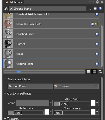

I opened a file originally created in Rhino 8 in August. The material icons now show like this, but not for all materials. When I try to create a new material (Custom in the picture), it also shows the same icon anomaly. The materials with the odd icon are not displaying correctly in my scene. I am in Beta from 10/24.
Materials error
Not sure what the anomaly is you are talking about. Right-click the offending material and select to save as a file. Attach the resulting .rmtl file here so we can investigate.
The material name cannot be displayed on the Materials panel! emmmmm,

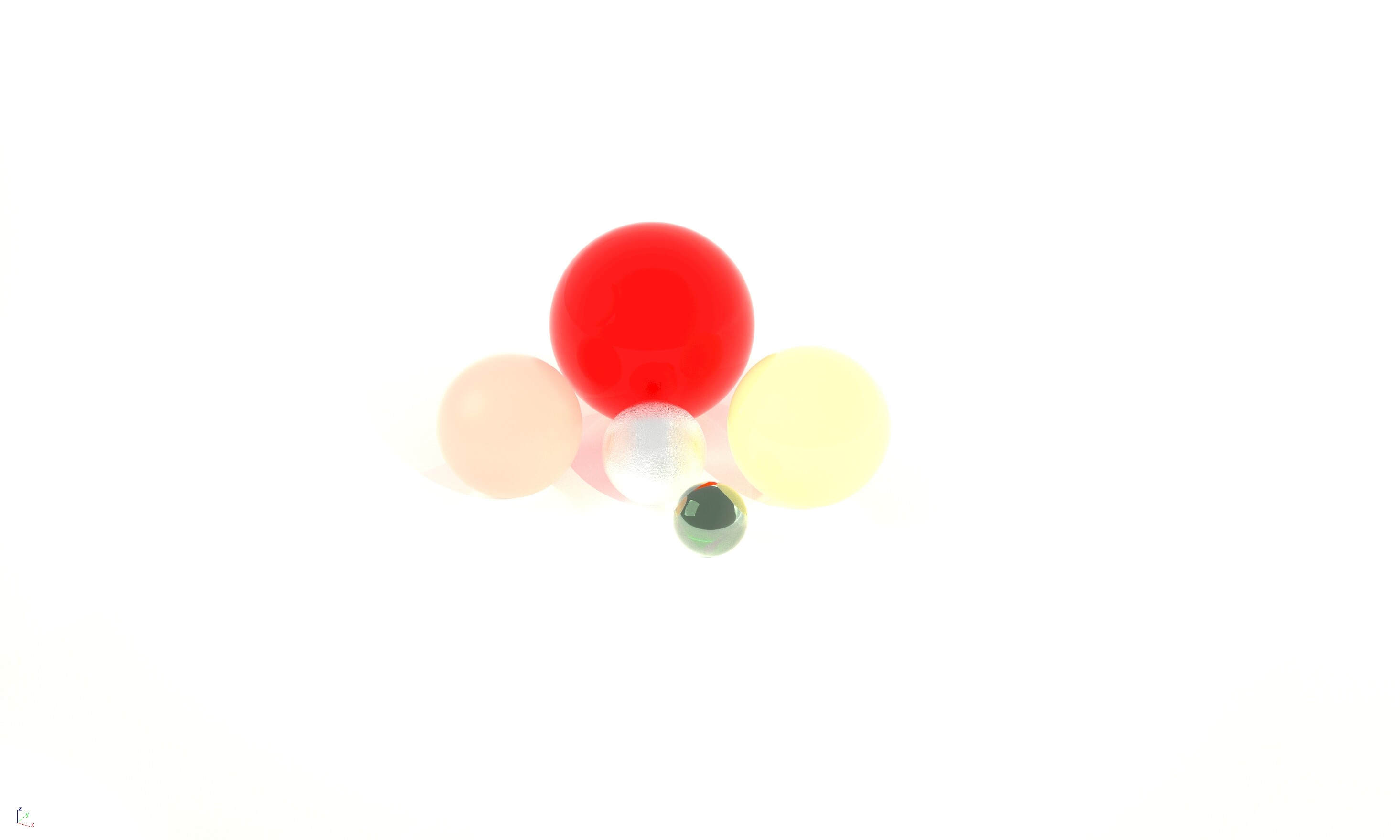

Below is a picture from August 9th using whatever version of the Rhino WIP that was available at the time.
I saved the 3dm as a Rhino 7 file. I opened the file yesterday and the image looks like this:
I start with the Lights panel, but the image looks the same with all lights disabled. I then go to the Materials panel, which looks like this when I begin:
Ground Plane 1
I change the Ground Plane color and then the icon looks like this:
The color does update in my image if I switch to Shade mode and then back to Raytraced. The icon corrects when I return it to the original Light Gray color. Here is the material:

Don’t get hung up to the fact that the rhino logo in the preview model gets a brighter - there is already a bug report for that, but it does not affect materials otherwise. The gray of the material is still correct in the ground plane material as far as I can tell.

I have figured out how to correct the Rose and Yellow materials. I’m still working on the brightness, which seems to be influenced by the Light Dome layer.
The overexposed issue is due to the shadows-only groundplane. Further I’d change custom materials into PBRs. Apparently more has changed, and I don’t have yet a good view on what exactly. I did turn off the light dome layer, I haven’t looked into what it is yet.
Here with materials fixed up, light dome layer turned off and groundplane (shadows-only) turned off.

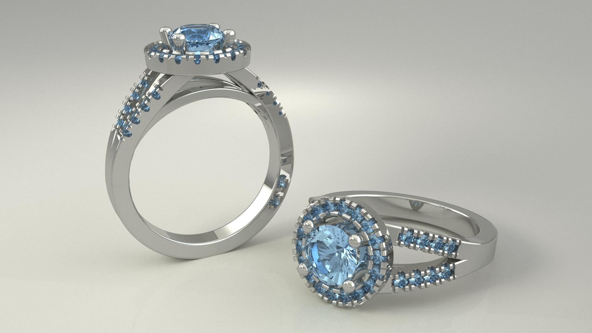

I teach Rhino for jewelry design and I’ve been experimenting with using three point lighting with a light dome. I’ve been getting very good results and students are producing better renders. The light dome diffuses the effect of the environment so it is more balanced and eliminates unsightly reflections. Here is an image with the light dome:
Here is the exact same set up with the light dome removed:
Thanks for figuring out how I can still use the light dome!
