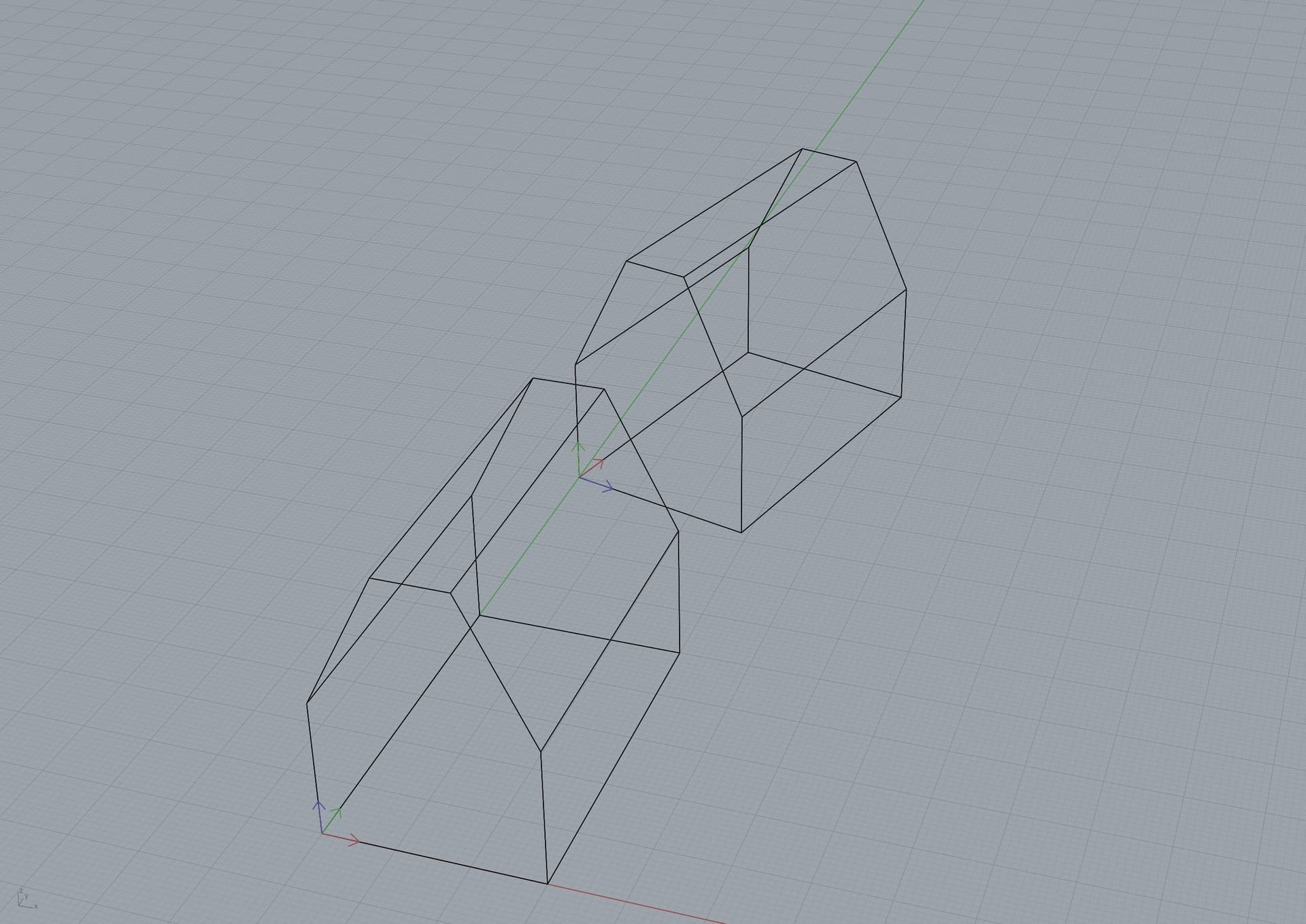

I am trying to understand CPlanes. I have 2 buildings in a model, with differing front alignment angles. I want to create Layout Details for each building, with each orientated to the relevant angle. My understanding is that the trick is to activate a Layout Detail and set the relevant CPlane, then set the Camera to the relevant CPlane Front or Right elevation.
On the Layout page, the left Details relate to Building A on the World CPlane. The right Details relate to Building B on the TS CPlane.
The lower right Detail shows the Right image aligned correctly to the TS Plane, although I had to select Camera CPlane Top.
In the Perspective view, I note that the TS CPlane lines are red and green for X and Y, but the arrow colours are confused - red instead of green, blue instead of red, and green for Z.
The upper right Detail is intended to show the Front image, but it only shows when I select CPlane Right or CPlane Left, and then it is rotated at 90 degrees.
CPlanes01.jpg was captured after activating the World Top CPlane, and it shows 2 sets of coordinate arrows, with colour confusion. CPlanes02.jpg was captured after reactivating the TS CPlane, and it has removed the World coordinate arrows.

@wim I have reproduced the widget colour confusion…
In Perspective view, activate the TopTS Named CPlane.
All is good.
Switch back to Perspective view.
Activate the FrontTS Named View.
The colours are confused.
The same colour confusion occurs on the Perspective view even when the FrontTS Named View is activated from the FrontTS ortho view.

The first one shows a parallel view with a custom “Top” CPlane. The unrelated CPlane widget is at the world origin and shows the world X and Y axes.
The second one shows a perspective viewport where the active CPlane is aligned to the front facade of building B. The CPlane widget shows that the “World Top” CPlane is still selected in the list of named CPlanes.
As I wrote earlier, the widget merely indicates which item is marked in the Named CPlane panel. It doesn’t denote an active CPlane and doesn’t move to a different location unless a different item is marked in that panel.
Perhaps I’m finally starting to understand what you mean with color confusion…
(I tend to need the teaspoon…)
Does this image show that issue?
If so, that’s because there is no correlation between the widget and the active CPlane. The widget shows what’s selected in the list, and the grid with the axes show the active CPlane. If both did the same, one of them wouldn’t be needed.
