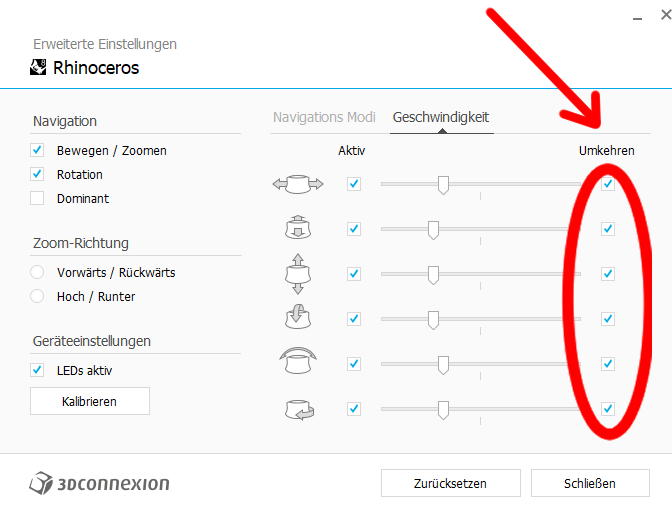

I’m using Windows 11. In Windows search if I type 3Dconnexion and then select 3Dconnexion Settings:
Advance Settings for this includes reversing axis:

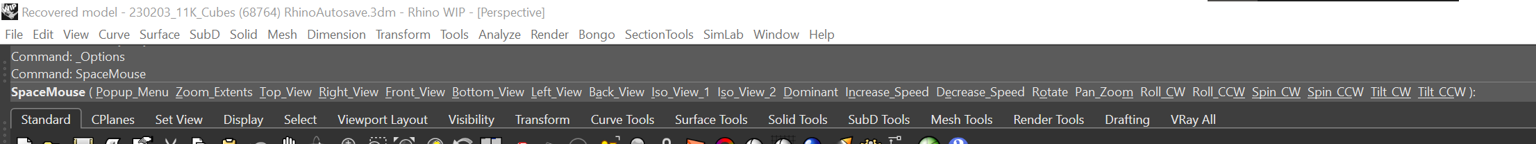

I also discovered there is a command called “SpaceMouse”, which brings up some options:
The first one brings up a popup menu with the options I was looking for:
It seems for some reason the default is set to Target Camera Mode. Object Mode is the one I am after.

For cripes sake! :slight_smile: The short answer is
  1. Command: SpaceMouse
  2. Select: Popup Menu
  3. Choose : Object mode (dot in front) This is the “normal” operation
Rotate and Pan Zoom need to be checked
Feel free to chose whatever else suits your fancy. This worked for me correcting “backward” SpaceMouse…
