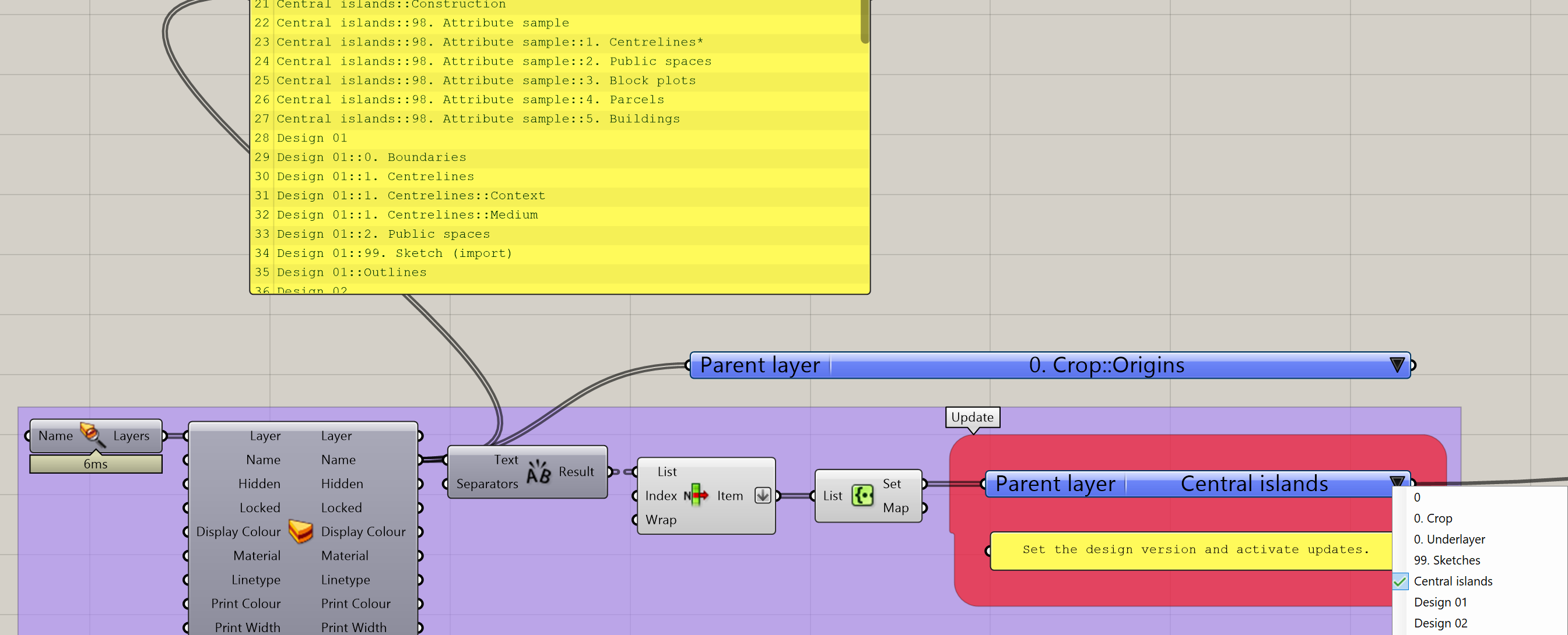

  3. As for layer querying, I would really like to have a dedicated item selector for this. To illustrate, I used Human’s item selector:
    What I would like to have is an input box where you could type in a layer name and have autocomplete (like in VSCode) to suggest possible values for layers names. It could have buttons to restrict search only to parent layers or to filter for child or grandchild layers.
    E: Recording cut off the part where I point that the circle is in the “circle” layer and the rectangle in the “I want this layer” layer.
    E2: Basically this, but all in a single item selector by enabling the parent layer button in the item seletor:
    Note the big difference in the component size that is enabled by stripping all the nested child layers out of the layername.

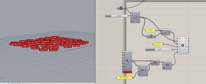

Just to add on the text dot:
I would appreciate if we could choose to give depth to the draw order of the text dot position.

Lastly, your suggestion for querying layers is a good one. It’s one we’ve discussed internally too. In fact, this is on our roadmap and should apply to any parameter which incorporates one of those list boxes. The thinking is that there would be a text box located above the list box where you could begin typing in a filter name and it would filter the items shown in the list box based on your filter. So, this is planned, but I don’t have an update as to when that might occur.
You should be able to set the Draw Order in the Drafting Attributes component. Essentially you would connect your Text Dots to the Geometry input of the Model Object Attributes component. Then create a Drafting Attributes component and set the corresponding list of Draw Order input values. Finally connect the Drafting Attributes output to the Drafting input of the Model Object. This should fix this issue (at least when the text dots are baked).
Setting the draw order isn’t really going to solve the issue for perspective views as it is just going to slam a text dot to the front or back no matter what camera angle is being used. This feature is something that needs to be adjusted in Rhino’s core display code and is not something that a component can fix at the moment.

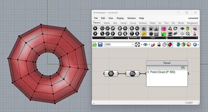

I would use GH point clouds every day. Yeah, I know I’m the only one.
Rhino 8 WIP can now reference Point Clouds using the Point Cloud parameter (Params->Geometry->Point Cloud). We haven’t really exposed any components which lets you deconstruct a point cloud, etc… but you can at least access them now in GH as a native type. You can even convert a mesh into a point cloud (using the vertices as a PC). So, it’s not a complete solution yet… but it’s a start :slight_smile:

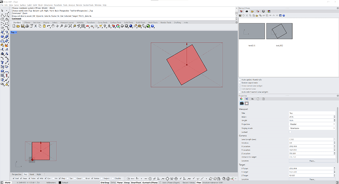

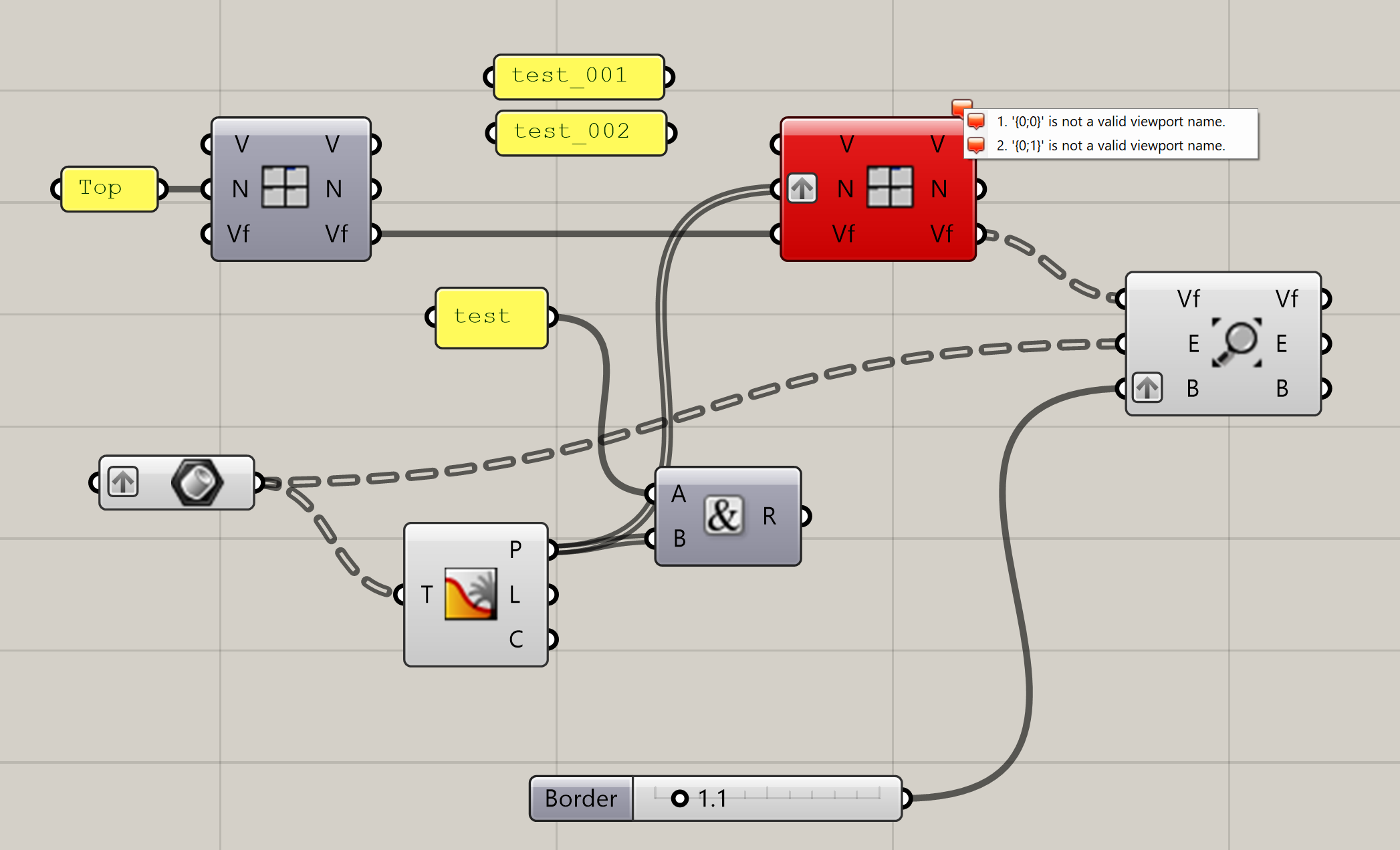

This is interesting especially when many named views can be created at once. I’ve been doing that with a script until now… Below is a definition that should bake two named views but only one is baked and I couldn’t delete it anymore.
I’m struggling to bake two named views at once. Also when I plugged the paths directly to the view name input, it raises an error…
bake_zoom_extents.gh (20.0 KB)

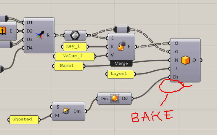

I do like this new components. Quite useful but still missing one big feature: a BAKE entry for each component that can be triggered from a button.
In my projects I do trigger multiple bake actions for different components using the Elefront BakeAll feature.

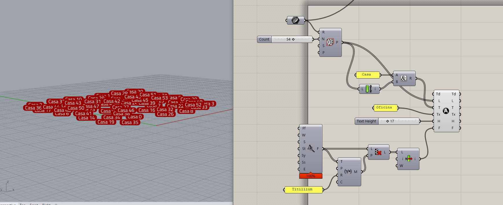

@AndyPayne there appears to be a bug in the Text Dot component, if I bake the text dot from the top position, it does not adhere to the layer I chose in the bake dialog.
afbeelding
Instead, the baked text dot consistently appears on the current layer or another layer, but not the layer I chose.
This is in Rhino 8.0.23080.12305, 2023-03-21 on Windows 10.
