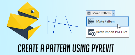

Making custom hatch from curves will be a very nice tool.
Yes. I agree. However, it would require some reconfiguration of how Hatches are stored/created in Rhinocommon and is a bigger project in general. This likely won’t be available in the near-term although it is a longer-term goal.
@eirannejad is the developer of pyRevit which already have a tool to make hatch in Revit.
Maybe he can help to create one for Rhino.
Hi -
Also see:
Thanks, yes i use it but it is limited
