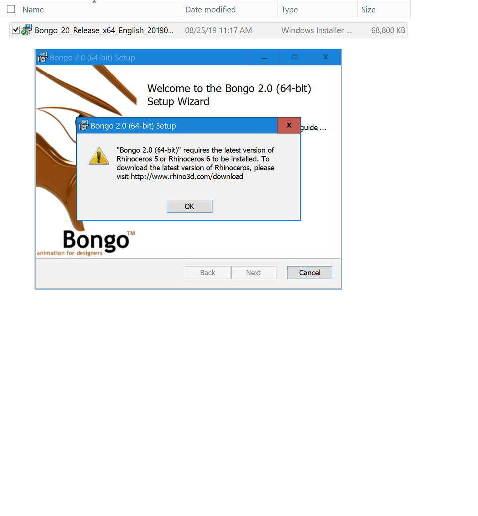

Hi @dalelear and @andy,
I’ve found a weird v6 vs. V7 incompatibility yesterday.
2 weeks ago I re-imaged Windows in my laptop and I didn’t install V6. I have not used it for for years now, I’ve only been installing V6 and V5 if I want to test some compatibility issue, or do some Tsplines work.
So I went to install Octane, Vray and Bongo on my computer that had only Rhino V7 installed. No V6 or no V5 were installed in this computer.
  • Vray failed, but It’s propably because I have an installer that was a few month old. Running their latest newer installer (vray_42001_rhino_win_x64.exe) fixed it. So it worked.
  • Octane also worked.
  • Bongo…
So I had to download and install Rhino V6 so I could then install Bongo for V7.
Still it didn’t work. There was no Bongo installed in V7 at all. after looking under the hood everywhere I found “C:\Program Files\Bongo 2.0 (64-bit)”
Dragging and dropping C:\Program Files\Bongo 2.0 (64-bit)\BongoUI.20.v60.rhp didnt do anything, but if I go a level deeper to C:\Program Files\Bongo 2.0 (64-bit)\Rhino6 I can dran and drop: Bongo.20.rhp. Only then I can go one level up and drag and drop: BongoUI.20.v60.rhp
Now Bongo seems to work in V7. But I’m not even sure if I did all the needed steps of I left anything behind/broken.
Since you know the developers and all, you might want to tell them to update this? :slight_smile:

Noted. The “developers” discussed this installer bug in today’s dev meeting.
Noted. …this is why I waited 5 days to report this bug.
I’ll leave you this Spanish literature anonymous saying:
You did all the steps to have Bongo running in your Rhino WIP.
