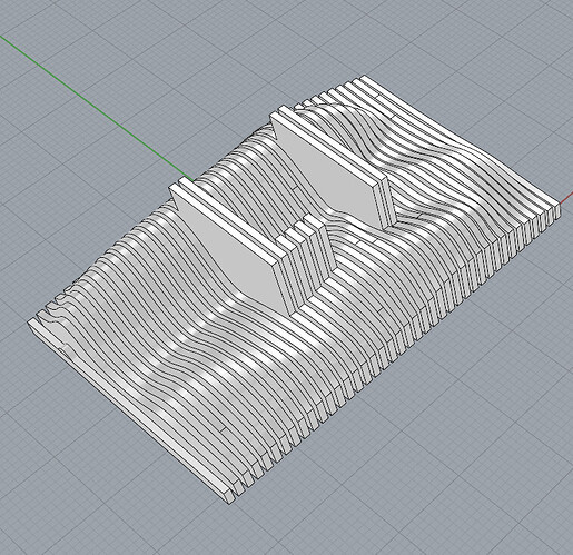

My boss needs me to design parametric walls for his CNC business and I have no idea how to use Grasshopper. I have done a bunch of research and used YouTube tutorials and I currently have 2 files that both work well. My current challenge is I can’t figure out how to combine them for the life of me.
The goal that I need to achieve is to create a wavy surface that I can then paste a company’s logo onto. In the “para wall surface set” file I can create any sized surface with whatever wavy pattern and then the GH file will chop it up to the proper widths and I can bake it. In the other file “para wall logo” I can take any image and it will paste it onto the parametric wall. But I don’t like that I can’t control the width of the strips and that I can’t make it wavy.
Please can someone help me out? I’ve attached a few links to the YouTube videos I used to help. Also, I’ve attached images of what I and hoping I can do with the GH file.

Hmmm… Interesting! Just to be clear your goal is to get something like in the image you posted (meaning a wavy surface from which the logo pops out as a straight extrusion)?

edit: Yes the above image is what my end goal is. Maybe I am approaching this incorrectly?
there’s no one single correct way, but i wouldn’t do it like this
i would convert the logo into a rhino curves that i can extrude
i would create a solid with a flat base (at the back) and the wavy surface at the front
i would then boolean union the two
then create the contours, and extrude them
