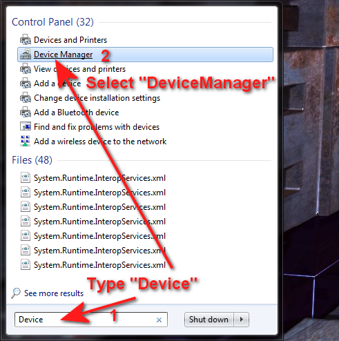

Here’s the process…
  1. Bring up the StartMenu by left-clicking the Windows icon in the taskbar…
  2. Start typing “Device” in the search box (without the quotes)…and you’ll see “DeviceManager” appear near the top… Click on “DeviceManager” to start it…
  3. Once the DeviceManager comes up, expand the “Display adapters” section…you should see your WX4100 listed. Right-click on the WX4100 and select “Uninstall”…
  4. Selecting “Uninstall” will bring up a confirmation dialog… It is very important that you CHECK the option “Delete the driver software for this device”… it will not be checked by default, so you will have to manually check it. Check the option then click the OK button.
  5. Reboot.
  6. Upon rebooting, reinstall the WX4100 drivers…then reboot again.
  7. See if Rhino works.
