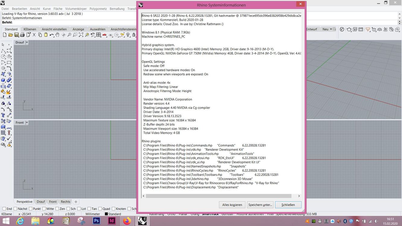

Here is the SystemInformation from Rhino:
Here in detail:
Rhino 6 SR22 2020-1-28 (Rhino 6, 6.22.20028.13281, Git hash:master @ 379871ece695dc096e83826f08b429db8ca2e7f5)
License type: Kommerziell, Build 2020-01-28
License details: Cloud Zoo. In use by: Christine Rathmann ()
Windows 8.1 (Physical RAM: 7.9Gb)
Machine name: CHRISTINES_PC
Hybrid graphics system.
Primary display: Intel® HD Graphics 4600 (Intel) Memory: 2GB, Driver date: 9-16-2013 (M-D-Y).
Primary OpenGL: NVIDIA GeForce GT 750M (NVidia) Memory: 4GB, Driver date: 3-4-2014 (M-D-Y). OpenGL Ver: 4.4.0
OpenGL Settings
Safe mode: Off
Anti-alias mode: 4x
Mip Map Filtering: Linear
Render version: 4.4
Shading Language: 4.40 NVIDIA via Cg compiler
Driver Date: 3-4-2014
Driver Version: 9.18.13.3523
Z-Buffer depth: 24 bits
Total Video Memory: 4 GB

Your video drivers are VERY old, that’s the first thing.
Thanks for your reply!!
This might be a stupid question: Are video drivers the same as graphic card drivers?
And does this mean I have to update the driver or rather buy a new graphic card (or video card) ?
Yep.
Yep. Both of them, the Intel driver should be updated too.
Nope. Although not the latest and greatest, you have 4Gb video memory on the NVidia card, I think that should be OK for most purposes

finally it works and the Wireframe View is displayed! :smiley:
It took me hours!
The Intel Driver was quickly found on the web and installed.
However, looking for the Nvidia driver I came across “DriverPack” and installed it (happy to find a tool for updating everything at once)…
That was a big mistake. I broke up the installation after three hours of waiting with no progress. And after that my computer slowed down noticeably (and things like OperaBrowser, Facebook, etc. were suddenly installed).
Just to let everyone here know: I cannot recommend this tool!
Afterwards I downloaded the graphic driver directly from the Nvidia website.
I’m grateful for your help! Thank you! :slightly_smiling_face:
