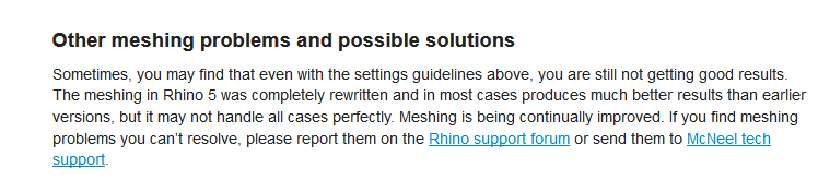

I like this part the best: :smiley:
Other meshing problems and possible solutions
Sometimes, you may find that even with the settings guidelines above, you are still not getting good results. The meshing in Rhino 5 was completely rewritten and in most cases produces much better results than earlier versions, but it may not handle all cases perfectly. Meshing is being continually improved. If you find meshing problems you can’t resolve, please report them on the Rhino support forum or send them to McNeel tech support.
