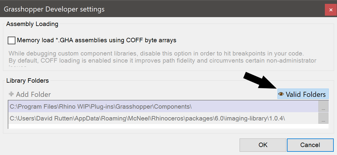

Ok I see one that’s probably it. Unfortunately it doesn’t seem to have any helpful information. It does appear that it’s crashing in the loading of Grasshopper plugins. Can you run the _GrasshopperDeveloperSettings command without problems and show me which folders are considered during loading?
no problem in running the _GrasshopperDeveloperSettings command
This is the screenshot
Ok, so it seems you’re loading a bunch of non-standard libraries. It would be good to know if one of them is causing the crash vs. a standard one. To test this you’ll have to rename all *.gha files in the directories c:\DIVA\64bitPluginFiles\ and c:\DIVA\64bitPluginFiles\ArchSim to have a different extension, for example *.notgha.
Those two folders should disappear from this list once they no longer contain any gha files. If it still crashes, I guess you’ll have to do the same for C:\Users\Francesco\AppData\Roaming\Grasshopper\Libraries\.

I worked out file by file and I did found the critical .gha file. It is the DIVA.Daylight.Classic.gha
located in the main Grasshopper\Libraries folder.
It is an old version of the DIVA for Grasshopper plugin so no problem to eliminate it since the
new plugin version 4 is installed as well.
