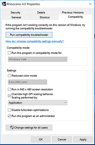

(Kapuscinskirichard) #14
Another way to make V4 work is by right clicking on the icon, going to properties, and selecting the Compatibility tab. Check the box to override high DPI scaling behavior, and set the ‘scaling performed by’ option to ‘Application’
It will make your menus display correctly (Layers, object properties, etc.). The only problem is that it will make all of your toolbar buttons smaller.
