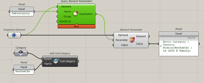

I’m stumped on accessing SubCategory info.
I have an element that belongs to a SubCategory of Structural Framing.
I have confirmed by toggling the SubCategory on/off in a view to confirm.
But when I reference via RiR, I’m getting a null…
@Japhy what am I missing?! Hope you are well.
Dan

Hi lignindes,
Please post the family and i can take a look. Thanks!
@Japhy
This is using Revit23, and Rhino7.
C-1000.rfa (480 KB)
Japhy
(Japhy)
4
Thanks,
In this instance that component is available to Get/Set in the Family document.
In the Project you can use the Element Geometry component to Get that info (not Set)

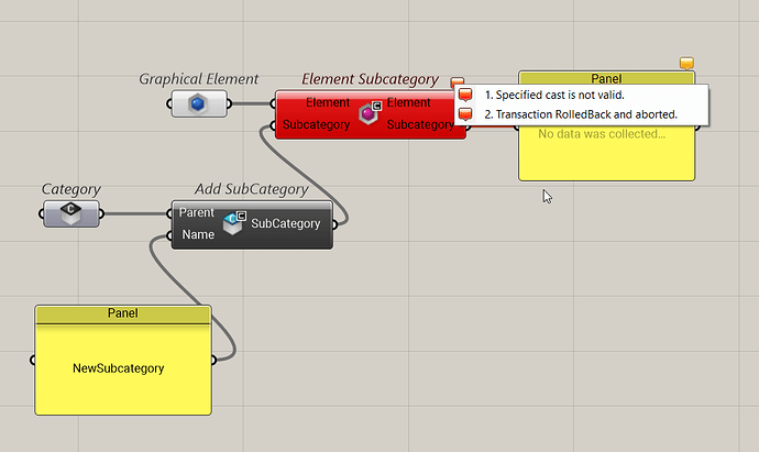

@Japhy
Another question, how to Query for objects in SubCategory?
Japhy
(Japhy)
6
See this recent post for more details…
MSAwan
( Muhammad Saqlain Awan)

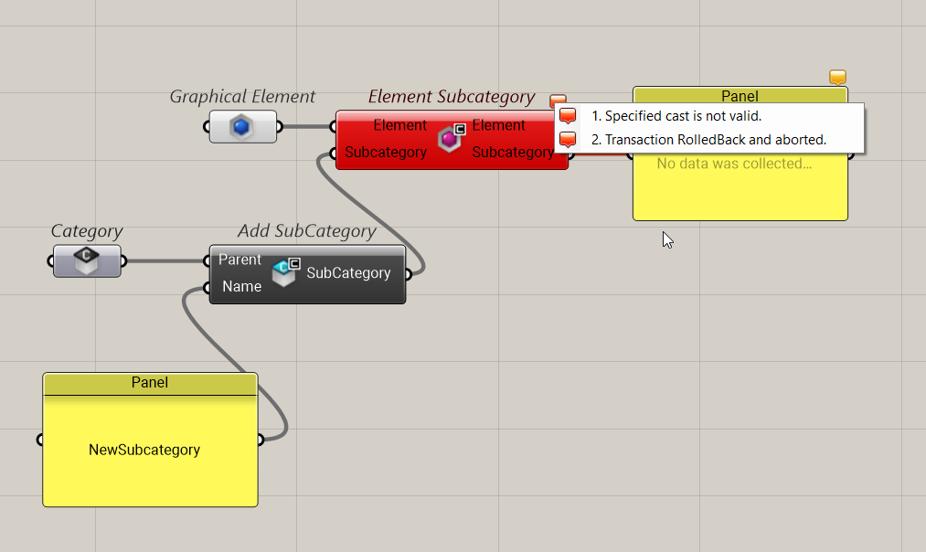

7
Hi @Japhy
The subcategory set option doesn’t wok properly
Japhy
(Japhy)
8
I’m seeing that as well, thanks for reporting.
