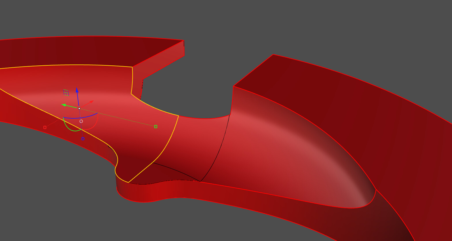

Hi All,
I’m having a little problem that may be solved. When you create curves as result of intersecting a surface with a polysurface , or projection of a curve over a polysurface with history, and you extract a surface of the polysurface, the curves disappear without preventing the user.
The workaround is to delete history for the curves first, but shouldn’t be an option to keep curves without history instead deleten them automatically?
Hi Joaquín -
I’ve put that feature request on the list as RH-88492 History: Request: Transfer to New Object
