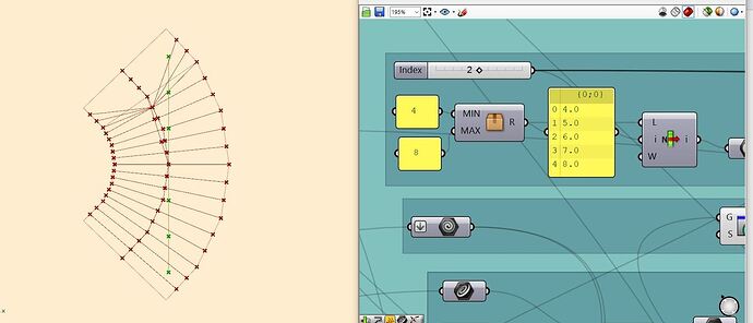

hello, have a long trouble here.
i tried everything as you will see.
got this model that i have to do some variety and every one of them has to work, its like a form finding of a hill. so when i give some height to the top, i give the same height to all points of the top, and then make it decrease from center to extremities, one for the north, on for the south.
so,
got that problem.
i tried to do sth but it doesn’t work :frowning:
you can see, EVERY HILLSIDE SHOUD BE PARALLEL. not weird things.
thank youuuu
replacing points for top of a hill.gh (344.0 KB)

i understand what you are saying, but i need that part to work with the whole model, cause the last to steps have to work with the second step, thats why i’m puttin the whole model, cause it has to work with variation.
here i uploaded with some annotation. in yellow, the part to check and i did some circle where to look. the yellow part works with the step 02. i put the names of the actions.
the cluster part is only a thing to choose the value to imput and other just to choose the name for that step.
i’m so sorry if is this complicated but i cannot reduce more for real!!!

replacing points for top of a hill.gh (254.3 KB)
well, i tried my best now!!!
i put both options but i need same definition for the 2 options. it works when its even list of peaks, but no for odd numbers.
how can i resolve this?
again, it’s a form finding of a hill, and in this part i’m fiving som height, and then differenciate north peaks and south peaks, so the heighest point it will be 1 peak (odd) or 2 peaks (even)
