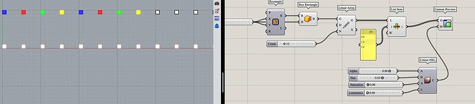

Repeat colour sequence
Could someone please recommend a method of parametrically adding colours to an array of objects in such a way that the colours could be varied numerically and the pattern could repeat itself over a chosen number. ( eg.repeat c1,c2,c3,c4, c1,c2,c3,c4,)
I know that I could do a bunch of list items with different colours but I wondered if there was a simpler method…
thanks
Giusseppe
Use the modulus component: index_of_element_to_color % color_count = index_of_color
[0 1 2 3 4 5 6] % 3 = [0 1 2 0 1 2 0]
do you mean this modulus ?..not sure how to use it
modulus
Btw, you could solve it in many other ways. Like you can use the sequence component. But the modulus solution is most mathematical solution, which is commonly used in programming
Thank you Tom
I saw something like this in a picture once but I could not figure out the expression that was linked to the series…I just guessed with x/3 …it generated nice subtle colours…do you have any idea what it might have been please ?

sorry, what I wrote didn’t make sense…the modulus is bringing two sets of values together, I see that…what I am wondering is , can an extra input into the numbers ( maybe random) inject colours into the series so that I am not choosing them with swatches?
That way the second list going into modulus would be more interesting than me just choosing the colours.
Generating 4 colours randomly ( or even sequential hues from an initial value) is possible, I suspect…I simply cannot work out how to do it.
I realise that this is more than I initially asked help with. If you could give me a reference that helps I would be grateful.
Giusseppe
