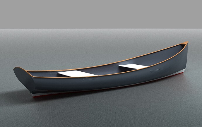

Rendering in R6 and R7, I’m having difficulty with materials. In the attached, the hull above the boot top is Navy plastic and the ground plane is “Water with Ripples”.
I’m trying to learn Rhino Render.
Both materials are brought into the model using “Import from Library”.
You have to change the size of the mapping of water with ripples. You probably have created your model in a millimeter template or similar.

Custom material is a bit broken in Rhino 8 at the moment, but you can change the material type to Physically Based (it is better anyway).
I’m trying to render in R6 and R7. How do I change the size of the mapping?
No matter which settings I’ve changed, all I get is sandpaper with no color.
You should follow the instructions here Rendering when Water with Ripples isn't and Navy is gray - #3 by keithscadservices

In Rhino 7 it will not be seamless as back then Rhino Render / Raytraced didn’t support Rhino procedural textures natively. Instead those would be baked to image files.
In Rhino 8 such textures are infinite, seamless.
