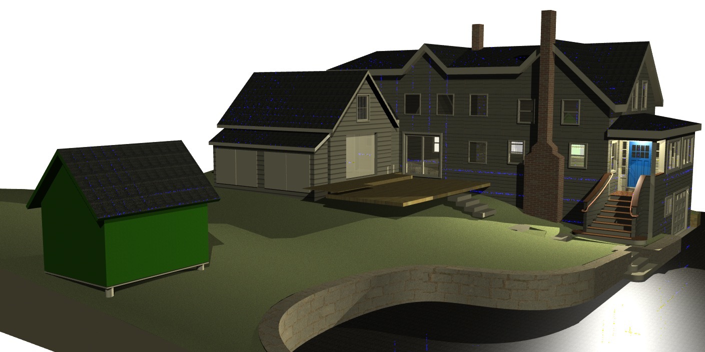

My render (on mid-2011 MacBook Air) leaves many trails of blue dots on an otherwise very acceptable render. Sort of in a grid pattern with several lines of densely spaced blue dots parallel to the 3 axes. Very annoying. I have tried all the anti-aliasing settings. I have tried different backgrounds. Not sure where to look next.
After looking at this some more, the blue dots seem to be lining up along the texture tiling boundaries. Must be some holes in the texture!

I spoke too soon, still getting blue dots (pixelated noise). I am confused on how this thing works. Whenever I fix one surface, the previously fixed surfaces and mapping widget get messed up. Maybe I need to make a unique material for each surface.

Pixelation is on the various roofs (roof shingles) and main house siding (siding shingles). I have been working mostly on the shingled side of the house that extends from the blue front door entry area, back past the sliding glass door, and then alongside the attached barn (i.e., the left side of the main house). I had also been working on the roof of the green woodshed. I get the shingles on the left side of the house looking correct and the mapping widget set to the size of that surface, then i move around to the other (right) side of the house and work on that side. Then I come back to the left side again and the mapping widget on the left side is completely different (smaller, in a different plane). So I am at a point where I would like to read some detailed instructions that describe what each option (in the material setting, texturing, rendering processes) controls. Is there such a resource somewhere? I have not stumbled on it and there are too many options to continue with the trial and error approach.

Thanks for all your help Brian. I did eliminate all the blue dot pixelated noise from the rendering. I stumbled upon a slightly different process than we discussed that I think works really well:
Set the U and V tiling parameters in the Textures part of the Material>Edit menu at 1.0 (or whatever values you want for the baseline material),
These values stays constant; there is no need to adjust this value,
In the Texture Mapping menu hit the âSize to Objectâ button to size the mapping widget to the full size of the object being textured,
Enter suitable values in the UVWRepeat entries (all the way at the bottom of the Texture Mapping section),
Here, larger values entered make the texture features smaller,
Also, adjust the UVWOffset and UVWRotation values as necessary to align the texture features.
This process enables control of the texture on each surface individually without having to join them and without affecting the previous texture mappings which happens if you change the U-V tiling parameter in the material menu. Therefore, the same material can be used on multiple surfaces, each with different texture feature sizes and orientations.
