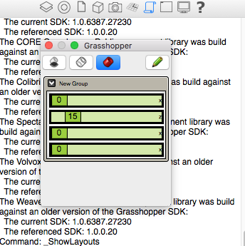

can someone tell me how to delete these groups?
i can add them but can’t seem to get rid of them.
(first attempt at trying to use remote panel
Click the pencil in the upper right-hand corner to edit the layout, then drag the group away from the RCP.
ha. duh. i thought i tried that but apparently not.
it works
thank you.

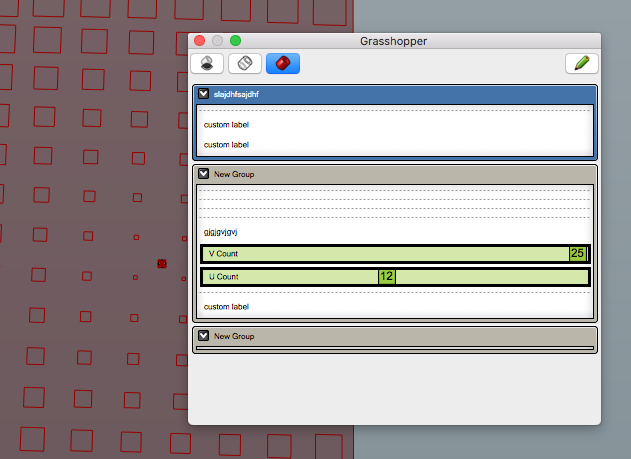

It’s only me or the letters of are too small? I can barely read on my monitor the labels called x z.
Here on webpage looks bigger, but in reality, on my monitor the letters are very small.
do you mean sidebar? or touchbar?
Or both if you prefer.

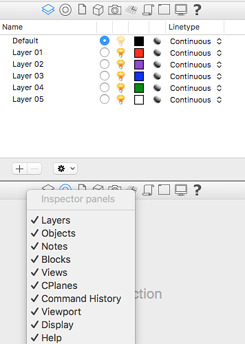

Hi, can you tell me how did you add Remote Control Panel in Rhino for Mac?
