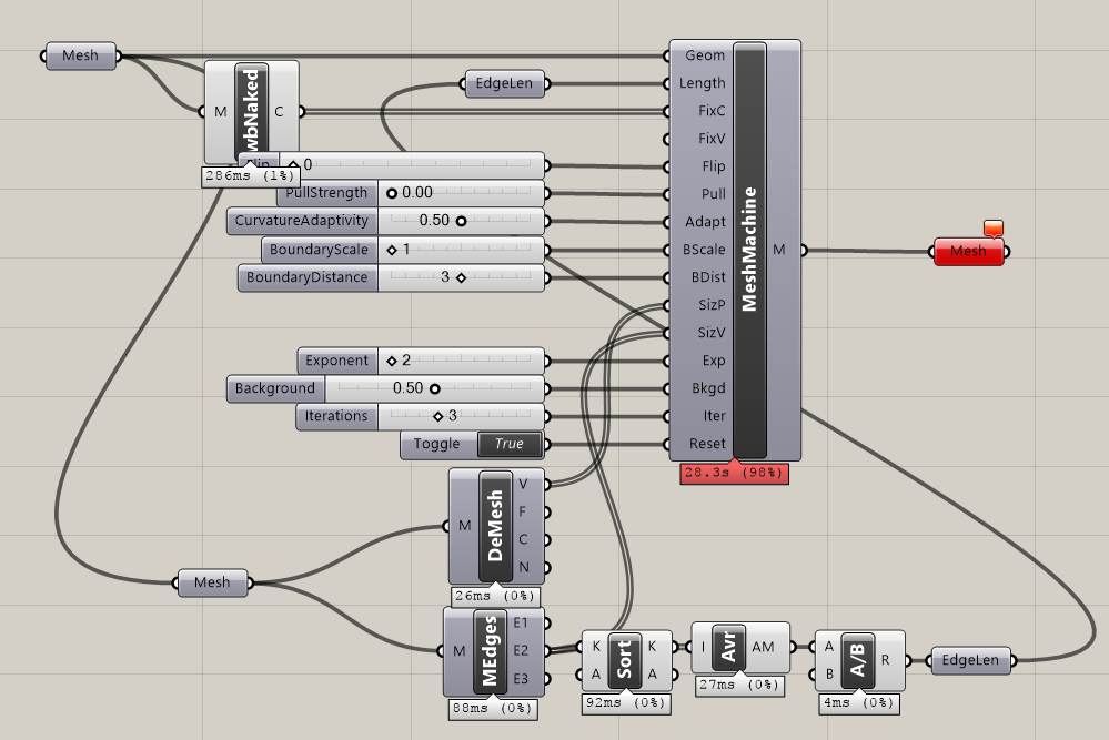

I’m trying out MeshMachine but I do have some problems with the input parameters, like:
  • Knowing exactly what (some of them) really stand for.
  • Knowing which input values are mandatory or not (most of them have defaults though).
  • Knowing what input values are valid (like SizeP, SizeV “to interpolate” - what is this, and where from can/should I derive such values?).
I managed to get the component to execute, but I understand that have totally useless input values since I don’t know what all of them actually stand for, or where from to get reasonable indata. Example:
Not all the input hints were useful to me:
https://rhino.github.io/components/kangaroo/meshMachine.html
Are proper input values something that you can give some hints about?
// Rolf
Hi Rolf - you may need to Weld the mesh at 180 deg. first. Worth a try if you have not…
Yes, I had figured that out. But I’m using another well documented tool now which I wrapped into a GH Component. Too many inports in the MeshMachine not being meaningful to me… :blush:
I prefer using things that can be explained. :slight_smile:
