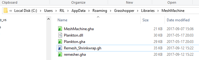

Unfortunately the component doesn’t show up, neither in Rh5 nor WIP. The first time I open up the GH definition I set the Plankton.dll’s, that was ok, but then it fails with the following message.
I do have a MeshMachine installed (in a separate Kangaroo tab) but it seems like something is missing or I have the wrong version of the Meshmachine? (at least it doesn’t look like your version of MeshMachine in your earlier post in this thread):
Where can I download your version of the MM?
// Rolf
Hi Rolf,
The file remesher.gha in my last post above is the version you need. Did you already try installing this one? Are there any error messages on grasshopper startup?
Yes I tried installing the files in your last post, but I get error messages. In WIP I get this:
An error occured during GHA assembly loading:
  Path: C:\Users\RIL\AppData\Roaming\Grasshopper\Libraries\MeshMachine\remesher.gha
  Exception System.IO.FileLoadException:
  Message: Could not load file or assembly
  'file:///C:\Users\RIL\AppData\Roaming\Grasshopper\Libraries\MeshMachine\remesher.gha'
  or one of its dependencies. Operation is not supported. (Exception from HRESULT: 0x80131515)
  Exception System.NotSupportedException:
  Message: An attempt was made to load an assembly from a network location which would have
caused the assembly to be sandboxed in previous versions of the .NET Framework. This release
of the .NET Framework does not enable CAS policy by default, so this load may be dangerous.
If this load is not intended to sandbox the assembly, please enable the loadFromRemoteSources
switch. See http://go.microsoft.com/fwlink/?LinkId=155569 for more information.
In Rhino 5 it doesn’t show up at all, not even attempting to.
In any case, I’m working on an application based on Rhino5 (still too many plugins missing for WIP for my project).
// Rolf
I just tested on another machine here in both R5 and the WIP and it works on both.
That error is often related to a file not being unblocked. Could you check that it is? Also, if there is another copy still in your downloads folder, try removing that.
Also, you might need to update to the latest Plankton release: https://github.com/meshmash/Plankton/releases
