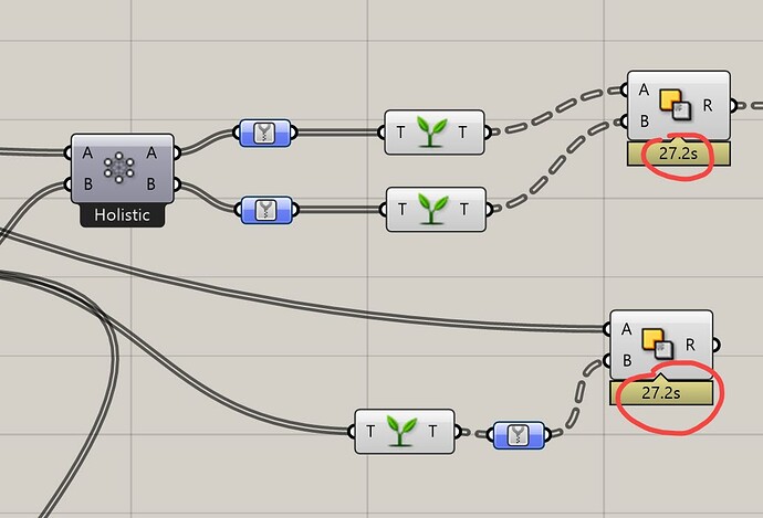

I just don’t get why “intersect region” can’t process multiple curves at once.
In this particular case, I have a circle and a bunch of polygonal loops.
If I feed all the polygons, nothing is output, but if I feed just the one that ought to work, it works.
This component could be super-powerful, but it isn’t because it requires a whole lot of cumbersome matching to get it to do it’s job.

Hi Joseph,
Well, the trouble is that I actually have a bunch of “A” curves too…
If you graft both lists, it won’t work, and if you graft only one, it won’t work either.
The only “simple” workaround I found was a brute force “Holistic” + grafting :
Brute force.gh (5.1 KB)
Oddly, swapping the ‘A’ and ‘B’ inputs without grafting works.
Intersect region_2021Apr25a.gh (10.6 KB)

It works, but does it make sense ?
As a sidenote, it takes the exact same time with the “Holistic” approach.
