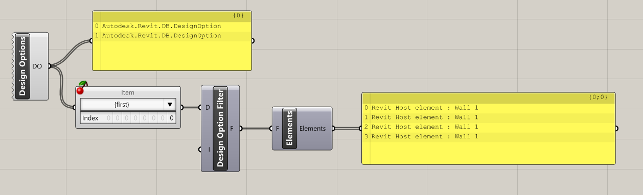

How to receive Design Options from Revit file in another way than selecting Elements and by Element.Decompose component? The workaround I described is computationally heavy task.
I need input for Element.DesignOptionFilter.
See the attached grasshopper definition. It has a python node to output all design options in a document
Any of the design options can be passed to the element filter

Back to the topic. If I remember correctly, your solution worked for me in the past, but strangely it is not working anymore. Maybe I was using Revit 2019 back then? Now I am on 2020 version.
Python component outputs design options but If I pass them to the Desing Options Filter, I am only receiving walls from the Main Model.

There was a bug with the Logical And filter that has been resolved. Please download the new Rhino.Inside.Revit release from here: Rhino.Inside®.Revit

I’m afraid currently there is no API in Revit to do this.

There isn’t a lot available in the Revit API for design options, Elements created will go on the projects active design option.
