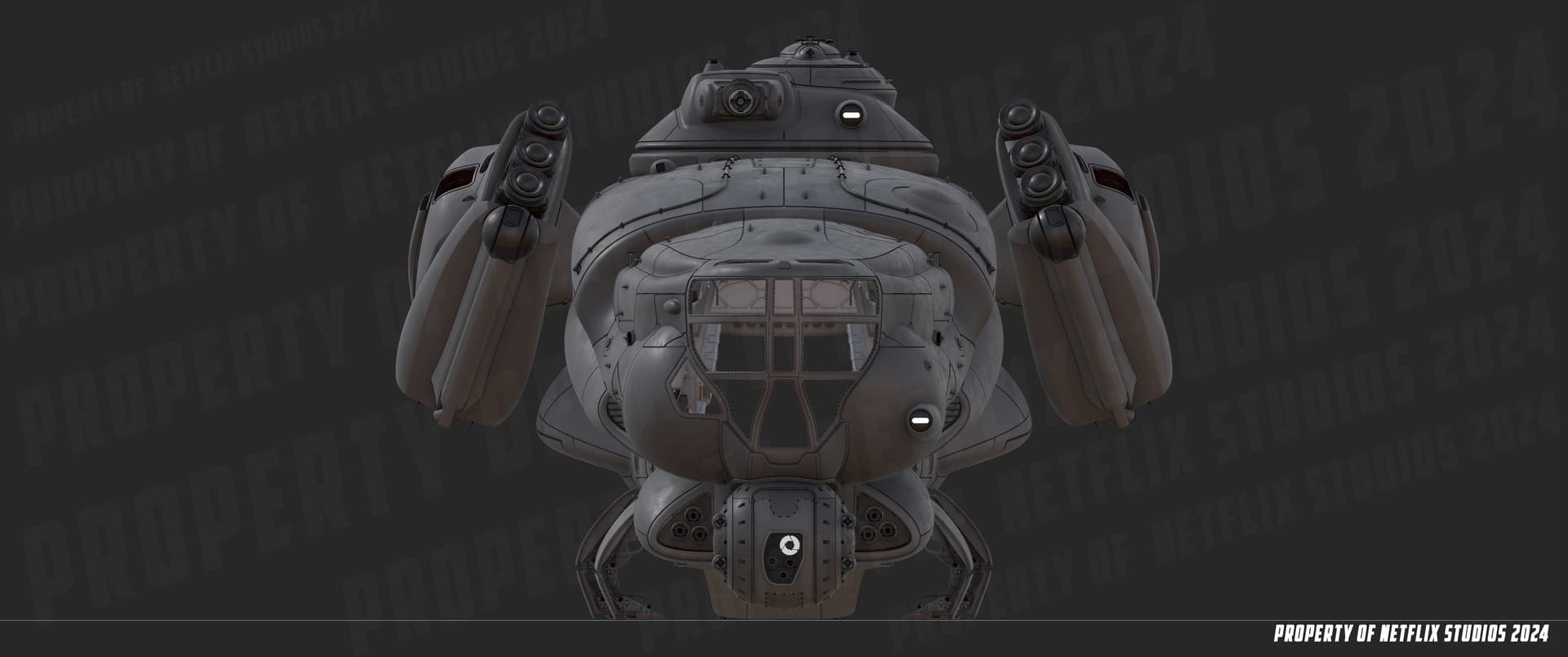

Based on notes from the director the concept illustrator did a rough massing of the vehicle to establish a look and feel. Once that was approved it was then handed off to myself to develop it further to be refined for fabrication and production needs purposes. This model was originally created in Maya I believe as sub d and mesh components. Not optimized for fabrication. Also many aspects were far from developed and required more in depth work.
Converting the concept to workable model:
Once I got the concept model I started by using Rhinos sub d tools to convert the meshes and start the process of clean up so I could transition it into a workable model . This went through many phases to further refine and respond to director notes.
Over the course of 4 months the forms were refined , proportions adjusted for size and volume requirements , landing gear development and crew cabin requirements.
For example here you can see the landing gear being worked out for deployment. We did not make them work practically but it still had to be worked out for visual effects.
Cabin spacing and flight deck requirements had to all fit within the physical exterior practically. Additionally a second interior was built for sound stage shots.
All modeling was done in Rhino 7. Some construction drawings were provided for purposes of meetings but the actual build was done by an outside vendor who worked directly from the Rhino files I provided. The flight deck and engines were designed and refined by a fellow set designer and Rhino user (you know who you are and again thank you , thank you , thank you. I could not have done it without you)
This is the final model as delivered.

Fabrication of the full size vehicle consisted of steel sub frame with carbon fiber shell. Many components such as landing gear and details were 3d printed all from the provided Rhino files.
In the end the result was quite a site to see in person measuring in at just over 50’ in length and 21’ high.

Yes, the development of the aesthetic design is done in the art department. The engineering is done by Aria group.
Yes from the point that I was given the rough concept to when the asset was delivered to Aria group was approximately 4 months. There were many adjustments and changes due to either script changes or the requirements of accommodations needed for production support. The landing gear required a good amount of time to develop due to the complexity of deployment and stowage. Its not faked as in most cases . The gear while not physically operational did actually work mechanically. This is why VFX was able to animate them correctly .

The landing gear was a real chore. Each one is slightly different due to the shape of the lower hull. Figuring all that out took a bit of time. But in the end it worked out pretty well. Better than the movie honestly.
Did you guys use software like maya to rig that? Reminds me of the time I was aspiring to become a 3d artist I had teachers from ILM that showed some impressive models like this it’s such a treat.
Im sure VFX used Maya for the CG shots yes. But for the design and fabrication it was all Rhino. And they took my model and optimized it for the vfx pipeline since the requirements are different for them vs fabrication.
