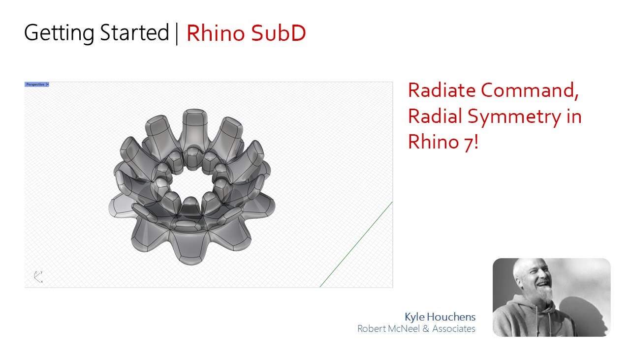

Radiate command- radial symmetry for sub d
In the first example of the video, if you use the Bridge SubD command does not work correctly, the connections are not made and reflected.
Is it a limit of command?
