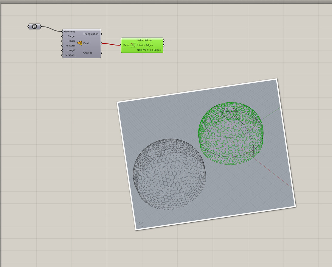

Not all hexagons (a few pentagons in the mix) but the new TriRemesh component in the Mesh section of Grasshopper in Rhino 7 may be of interest as an alternate workflow here.

Thank you for this! I used Weaverbird on grasshopper but it wouldn’t allow the ‘vertical’ wall-like part of the dome which is what I needed. From the image you have shared, it seems like ‘TriRemesh’ allows for that hexagon pattern vertically before dome-ing.
Could you offer any tips/directions please?
It’s seriously fun, just try it. You can feed in anything and the Dual output of the TriRemesh component will have that mostly hexagonal pattern. I like to throw a mesh edges component at the end to see the edge size controlled by the length input. That’s what you could bake out if you just want the curves. For added excitement, feed those edges into the new MultiPipe component to make a SubD. This is all thanks to @DanielPiker by the way.

I can’t think of a reason why the brep was causing problems unless maybe there was also a duplicated surface in there somewhere. There normally shouldn’t be any need to split Breps into separate surfaces.
HI @DanielPiker , for some reason my 4 quarters which are each a surface do not align with each other regarding the hexagons/pentagons. Any advice?
Can you post the file?
It looks like you have multiple surfaces being remeshed separately.
You need to input them joined into a single Brep, and turn the Sharp setting to False to avoid creating feature curves along the seams.

It looks like when joined into a single brep, the initial Rhino mesh created from that geometry before remeshing has some naked edges, even where the Brep doesn’t.
Here are a couple of different ways to resolve this - remaking the surface as a single revolve, or keeping it as a brep and aligning the vertices:
