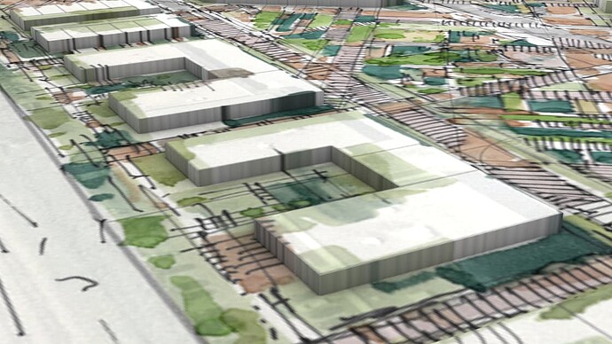

I am referring to the projection of image A onto the viaduct form - open polysurface.
I mean the texture should be in the same position on the viaduct form as in the image below. Simply duplicate it.

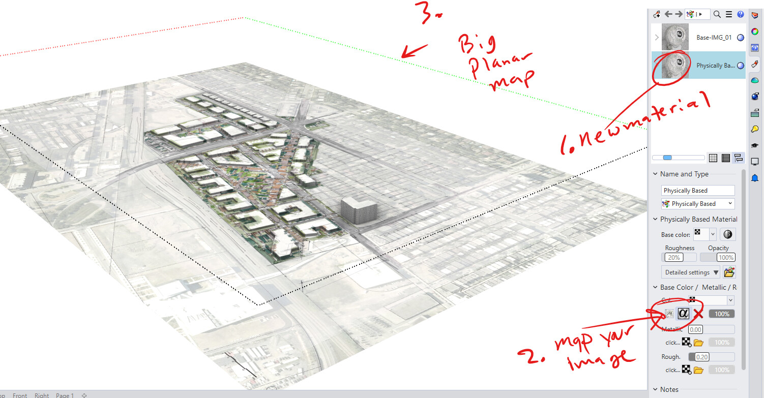

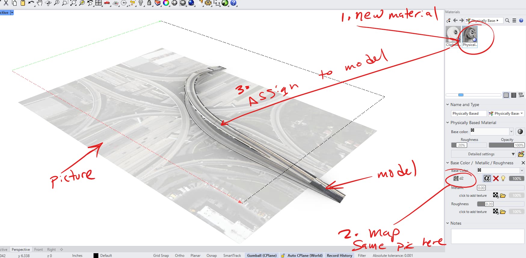

make a new material, (physically based) and in the base color channel add the image you are using on the ground plane
now select the bridge surfaces and assign that material.

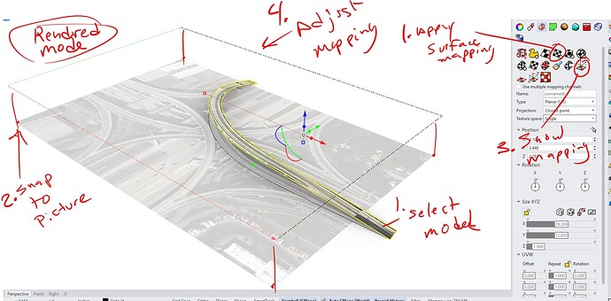

now with that surface selected go to mapping and apply a planar map
now show mapping and adjust it with the mapping widgets.
see below-
then select the model, and go to mapping, assign planar mapping and snap to the corners of your picture/ ground plane
show mapping and adjust as needed with gumball-

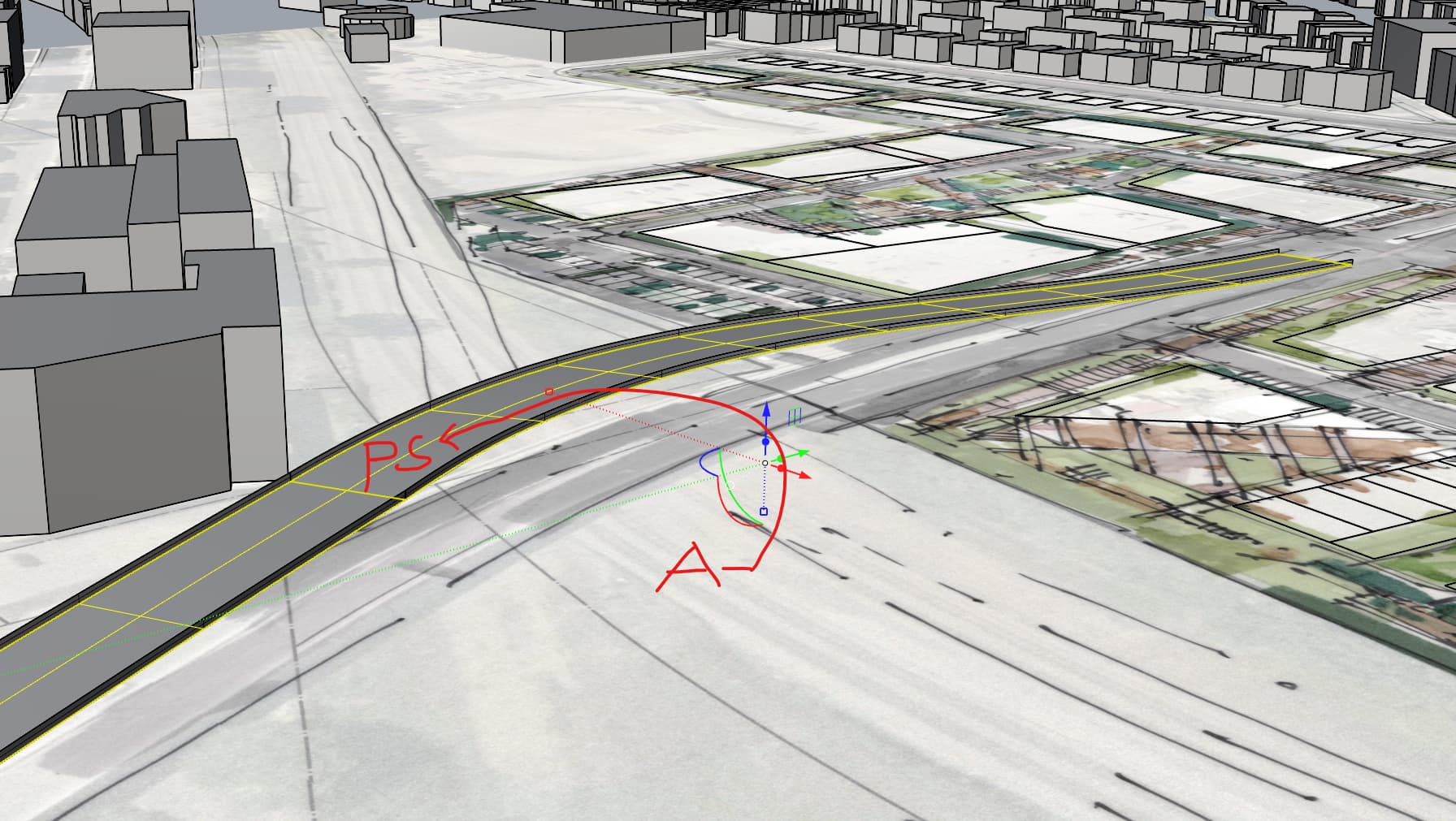

In the meantime, I am sending you a file with the situation regarding the issue.
I have been using Sketchup, where I think a similar procedure is very simple. Hence my uncertainty about the approach in Rhino, where I am just starting out.
The image is also below.

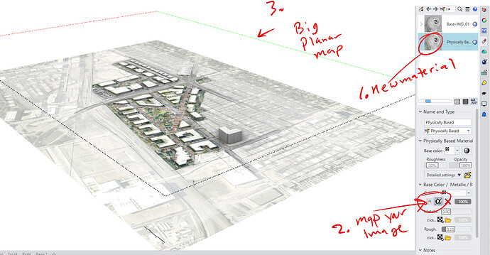

you can do this the same way I showed above-
one material, one image map, one big planar map
close up
fwiw, I changed the image map to 72 dpi in photoshop and the file dropped from 569 mb to 279…
